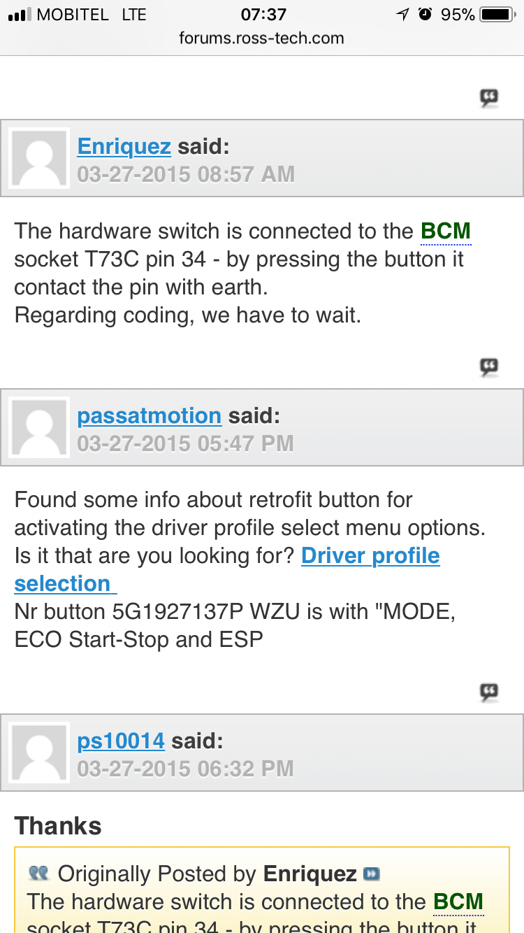

I would also activate that if its possible. For golf 7 you have complete instructions how to but also need button, is it possible for skoda did anyone tried, and if someone know pin locations where vRS button should connect for golf 7is like in the picture. Any help would be good.
That seems a little confused as on the golf 7.5 driver profiles are different to mode selection.
