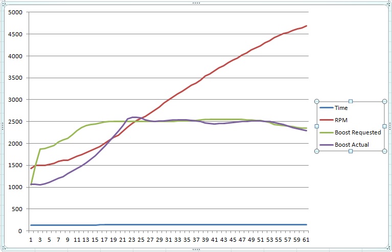

how does this boost log look?
to my untrained eye it looks ok but would appreciate it if some more knowledgeable members could give there opinion
Edited by ljphil78
If you want to set it correctly then you have to wind the rod off, read measured value block 120 and apply vacuum until it reaches 0.760mv then lock it off.

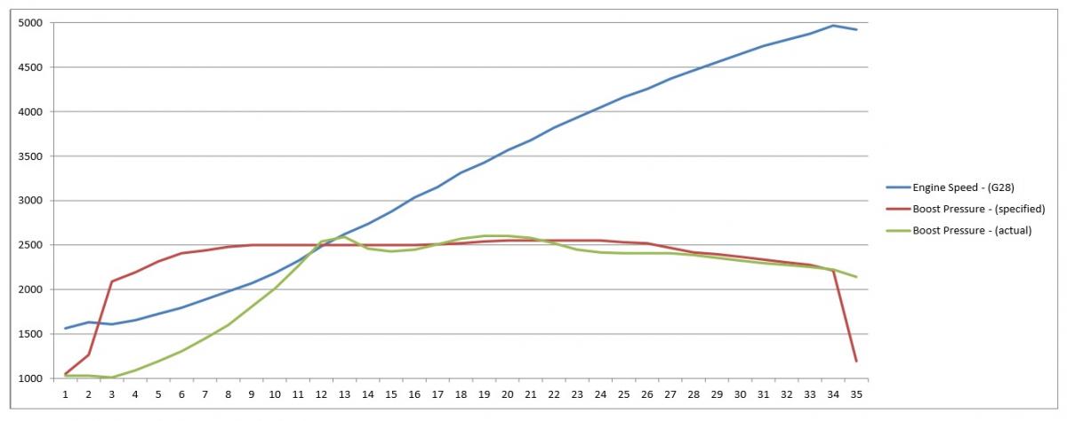

Well my vacuum tester turned up today so had a little tweak of the actuator rod and tried another power run
looks similar to previous result but does seem a bit better on initial pick up
