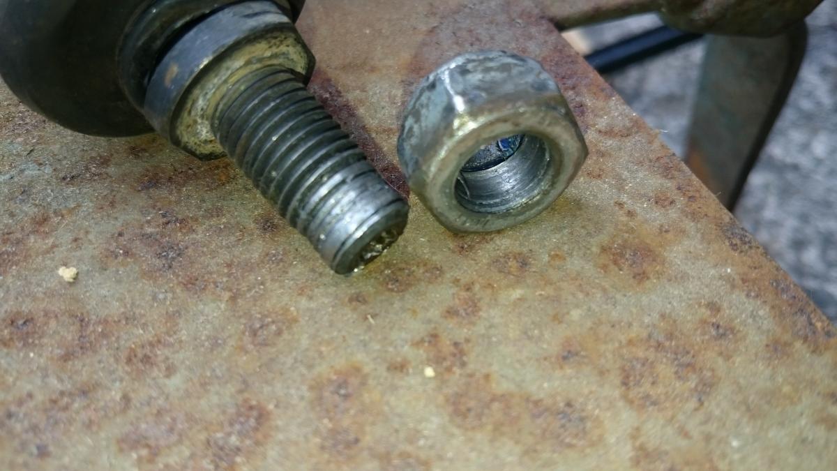

So I did my drop links today. No probs on the offside, but then I discovered this on the n/s. What sort of bellend fits it upside down? They'd stripped the nut and stud and as the short end was uppermost, it didn't even engage with the nylon portion of the nut. Could have been worse if it was on the o/s I suppose cos of the boost pipe.
Much quieter on the front end now :)
Watch that cv boot too, needs a clip
Well spotted old chap! I was so busy swearing I didn't notice that. Cheers bro.
