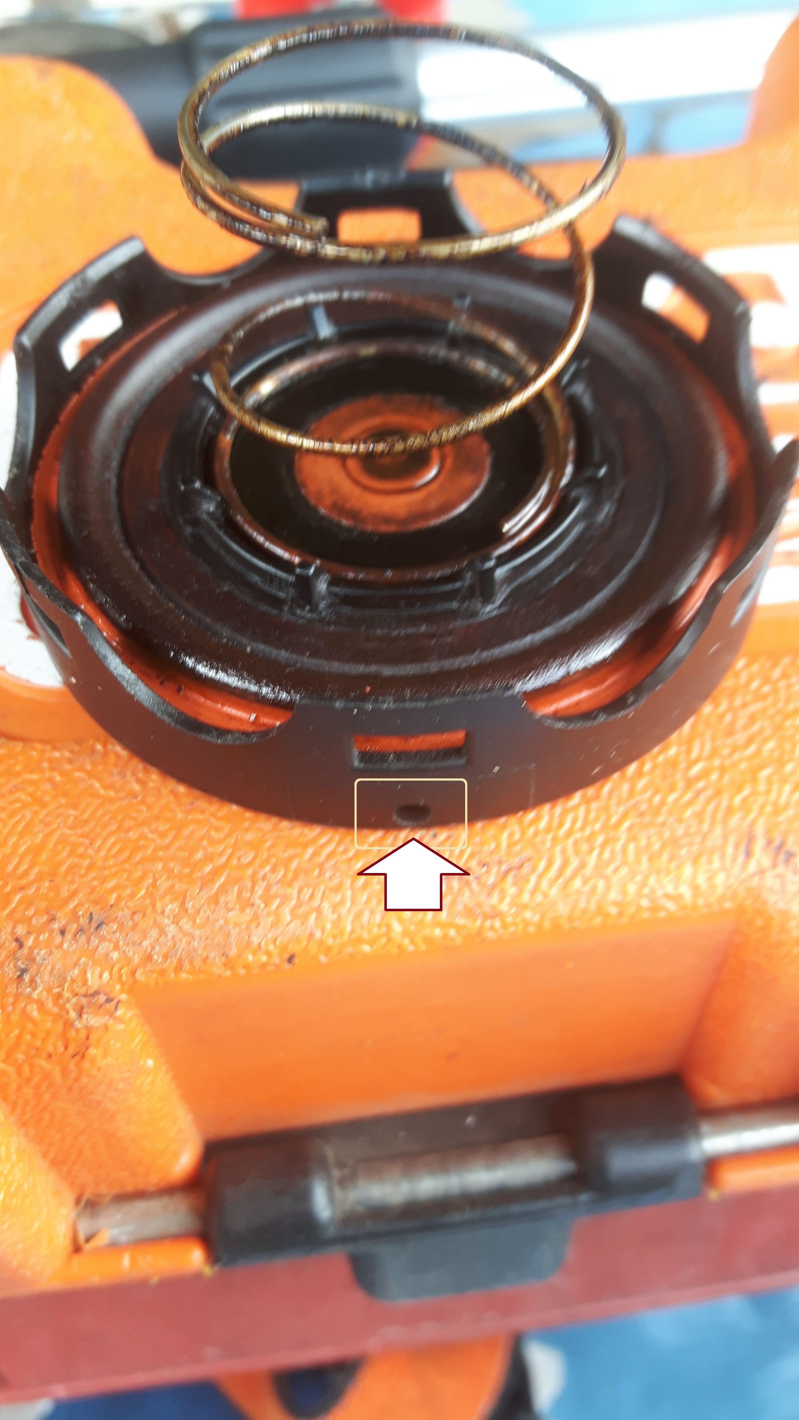

I think I finally got to the bottom of this.  A leak of air into the PCV valve was fixed, for reasons related to engine running/faults; and all of a sudden the brake servo is behaving like it did when we first got the car more than 8 years ago.
I might make a little video later, but the diagnostic for this fault is to stick a finger over the pressure equalising port of the PCV valve while the engine is idling, fully warmed up.  There should be no effect if all is well with the valve.
If the diaphragm in the valve is leaking, things will be different.
Here's a photo of the valve cap/diaphragm/spring (upside down compared to how it is fitted on the 1.2 engines) with pressure equalising port marked:
I've noticed that my brake pedal drops ever so slightly when I have it pressed and turn off the A/C. I didn't notice the same thing happening in any of my other VAG cars. I wonder if somebody around here with a healthy car and A/C can check if that's normal or if that is indication of something amiss. Servo hoses seem healthy, pressure equalizing port in the PCV seems to be working as it should. TIA.
