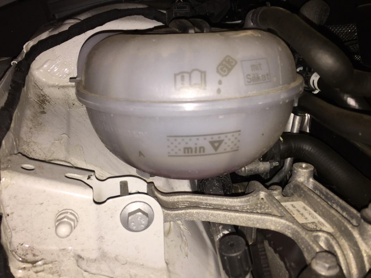

I have a similar question, so hopefully OK to jump on this thread?
My coolant light came on tonight (red not Amber)
18 month old car with 14k on the clock. Whilst I check levels, I've never had to top up any car with this amount of miles in such a short space of time. In fairness I usually only keep the cars for about 12 months, but I still think it's quite heavy consumption, or am I just being presumptuous?
I do drive the car quite hard and just returned from a 700 mile round trip.
I'll top it up tomorrow but is this normal?
Picture, you can just see how low it's actually gone.
Yours looks like its leaking from the plastic header tank - that white staining is coolant; most likely from the hose or the pressure cap
Thanks, I'll take a look over the weekend and see if anything is loose etc. I'll consider the dye, but it can go back to the dealer to sort as it shouldn't be doing that already.
most likely a faulty header tank cap
Edited by Wakey
