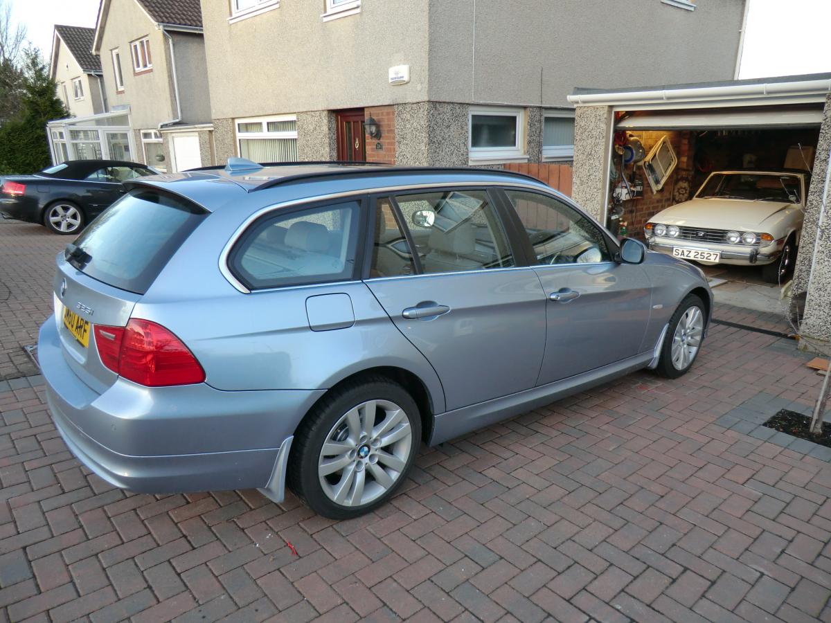

Honestly I think that looks terrible.
The flaps on the SIII are so unobtrusive that you barely notice them; that makes them stick out like a dodgy sore thumb.
This is mine with the standard flaps:
Edited by Kungfugerbil
