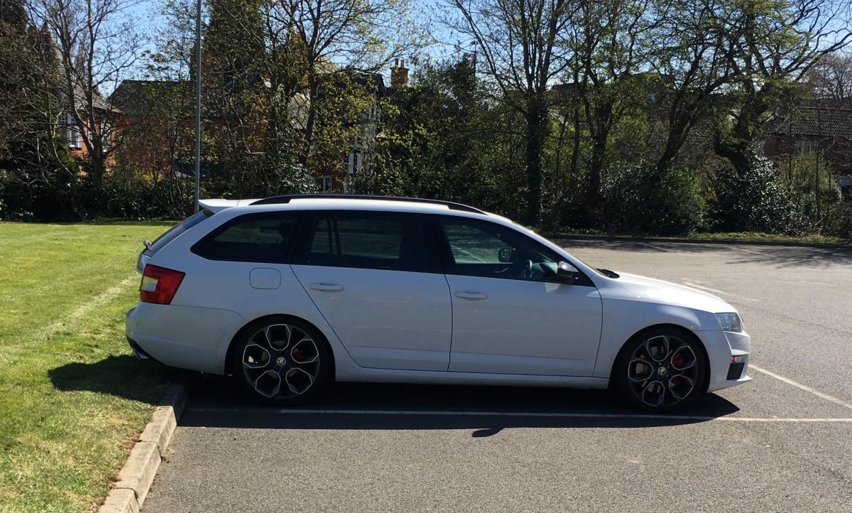

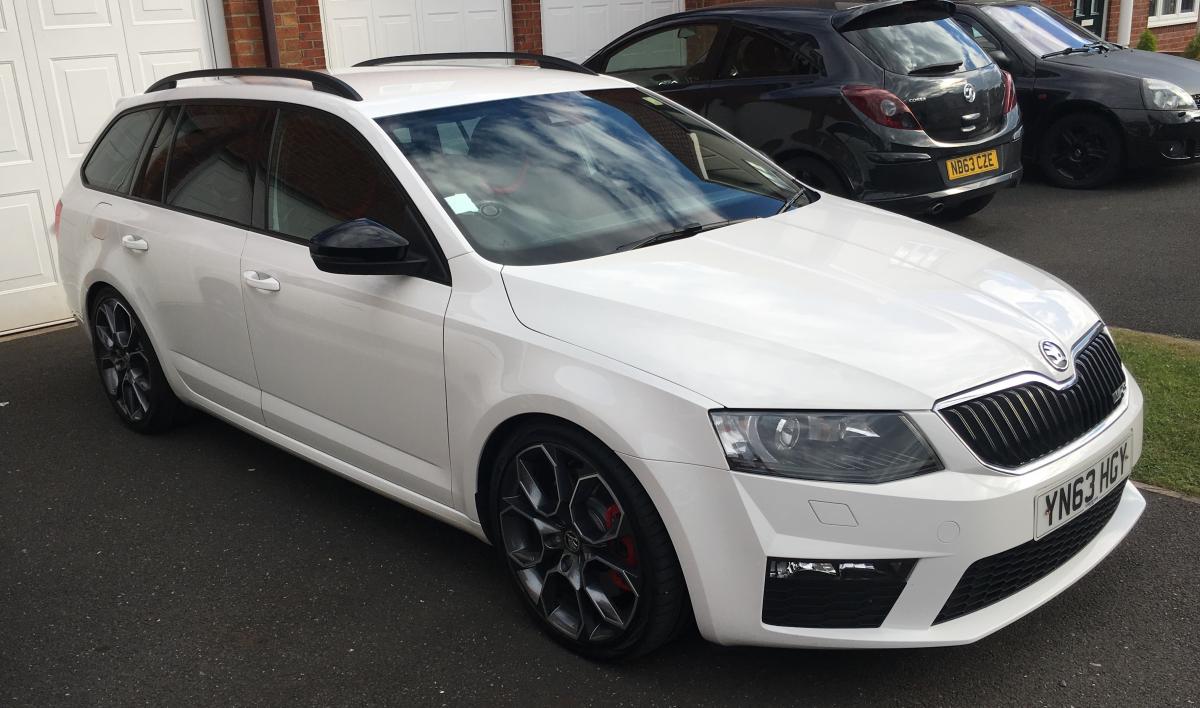

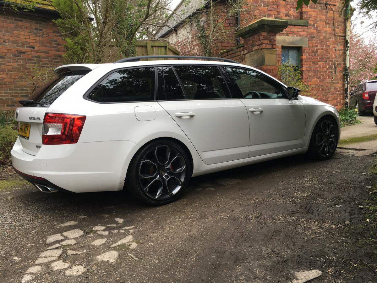

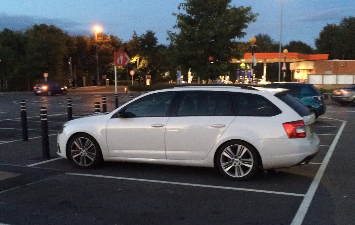

Thanks for your reply, do you have pictures of your car?
Last one with the 18" pictoris with winter tyres on
