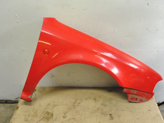

I need a new right front fender since mine is in bad shape, I was wondering which cars have the same fittings as my vRS? Since VW Passat 1.8t seems identical and non rs Octavias aswell, any more cars that share the same?
I'm wondering 'specially cause mine is rallye red and its hard to come by, by just looking for RS parts or they're all rusty etc.
Pic if front fender is the wrong word
Post facelift Mk1 Octavia front wings/fenders are only interchangeable with other post facelift Mk1 Octavia's unfortunately. Plenty in the uk but shipping to Sweden not a very good idea though.

So any Octavia MK 1 will do , RS or not? Assuming the colors match
Yeah they're all the same.
Any post facelift wing would do. The indicator repeater is in a different place on the pre facelift cars.
