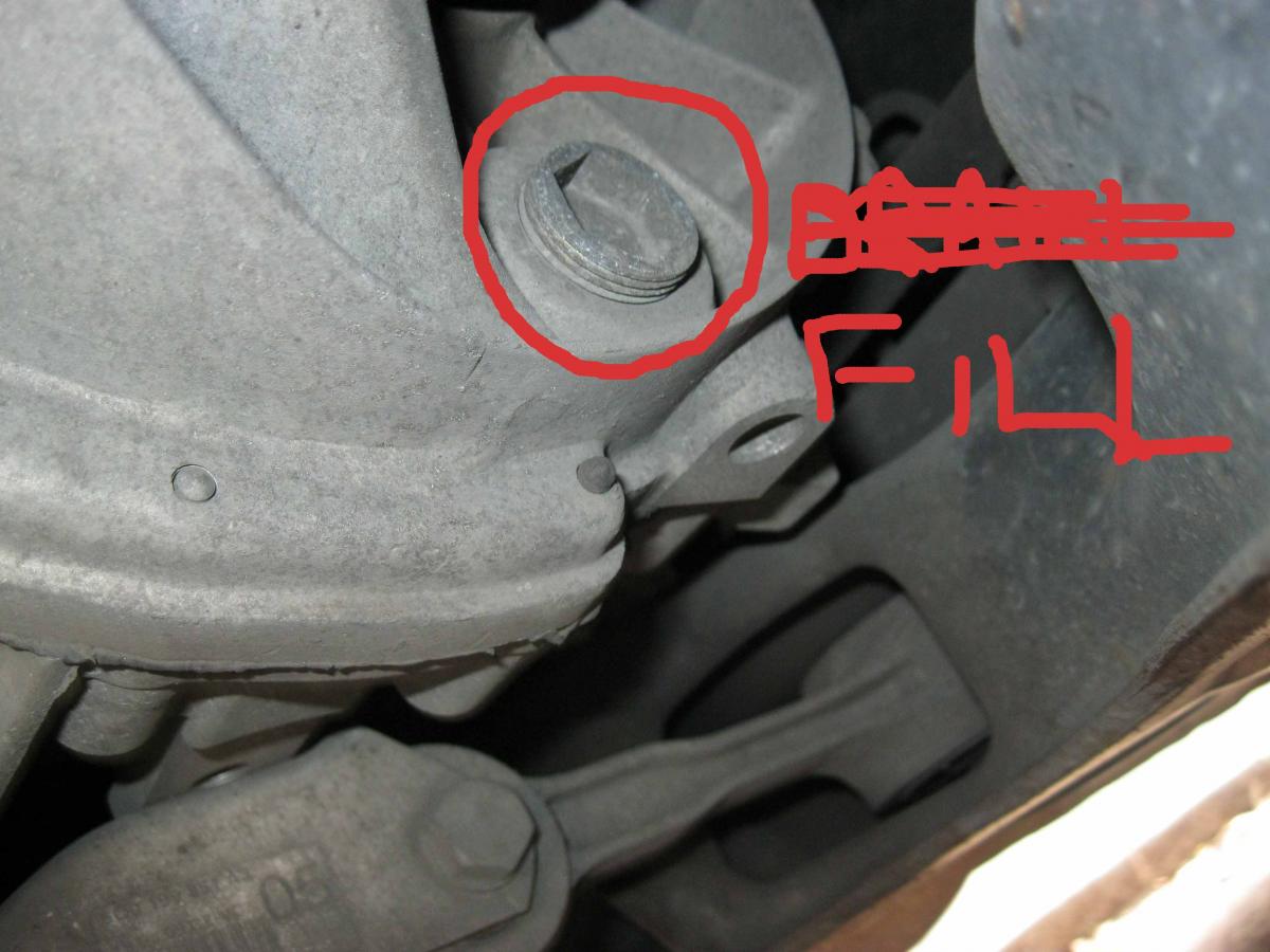

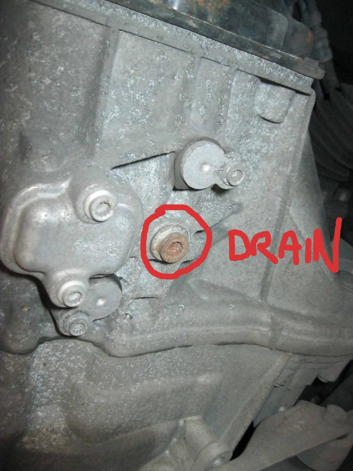

Please could someone confirm if I have identified the right plugs on the gearbox? what are the other similar hex nuts around the drain plug?
The drain plug is 8mm, while the fill I think is 17mm. Is this usual to have completely different sizes.
I ended up buying only 8mm hex, thinking both will be the same size.

I think the drain plug is just out of shot to the right of the 'n' of drain. It's basically on the opposite side to the fill plug, but a bit lower.  I'll try to find some photos of mine.

Ok I'm confused now. so are you saying the circled plugs are wrong?

Sorry, I was looking at this wrongly. The one you've labelled fill in the first photo is the drain plug, the fill plug is opposite, and a little higher.

The first picture circled FILL is high and it's I think 17mm plug.
The slightly confusing bit is the drain which also has other plug around.
  • Sponsor
No. They are both 17mm female hex.
The fill plug is where I've shown it in post 5, awkward to access on the driver's side of the diff. The drain plug is the one you've labelled drain, then crossed that out and labelled fill, in your first picture, accessible with NSF wheel removed.

So my circled drain plug is wrong.
I spent time looking around but couldn't find any other plug - well I will have to look again.
