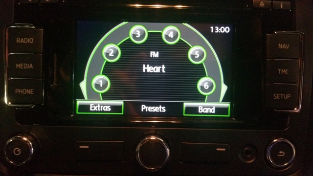

What radio is it?
Apart from it being the standard one that came with the car (with SatNav etc) not sure how I find out
Most likely an Amundsen Plus unit then. Does it say that on the front anywhere?
Just been to check and there's nothing on the fron which indicates what it is - however, I've taken a picture of it (hope it works)
Yep, that looks like an Amundsen, so we'll presume it's a Plus unit and Bluetooth is built into the head unit rather than a separate module.
Unfortunately I don't have much experience with streaming or the Amundsen units, but there are others who will know more. Now we have some more detail, maybe someone in the know will shout up. In the meantime, how did you get it to work initially? Have you tried any other phones to see if it's handset end or head unit?
