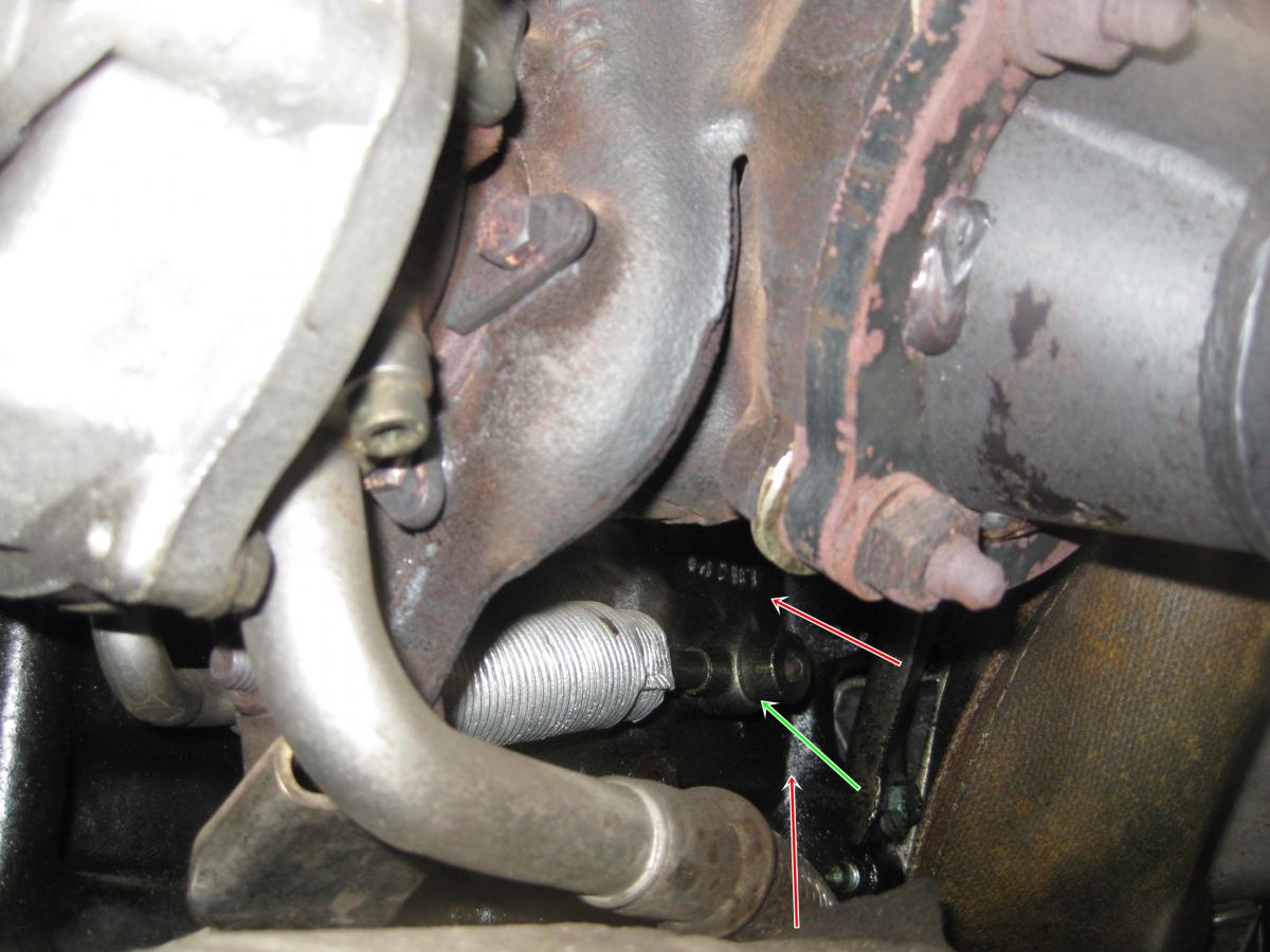

Just had my mk1 Octy vrs in for its MOT and the guy called me over to show me that there was an oil leak down the turbo side of the engine,the red arrows in the pic show fresh oil and what is this line the green arrow is pointing to ?
where about is the oil feed line to the turbo,i have checked the cam cover for leaks and it seems ok.

That's the coolant line for the turbo.
If there is oil down that side you can bet it's the cam cover gasket or camshaft oil seal.
Cheers for that Tech1e,i will investigate further.
