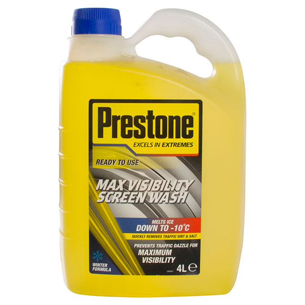

I bought gallons of screen wash 3 winters ago.  Or actually after winter, Much Cheapness, much crapness.
Just terrible stuff and i have loads left.
Edited by Offski
ah prestone, much cheapness in asda , halfrauds don't seem to stock it so would ring alarm bells with me
never tried it, but I tend to steer clear of cheap offers in supermarkets unless its a brand I am very familiar with (sometimes see rain-x on offer, and Castrol oils at good prices)
I also don't see the point in paying for "expensive water" used to dilute concentrated screen wash in the ready mixed, its just lazy and a waste of money
