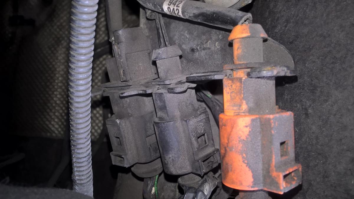

Thanks I'm aware of those on top of back of engine to the right as I look at engine.. There is one on it's own and what seems like 3 other valves one orange in colour!? Do you know what they are.. I can post pics tomorrow only.
Once you have the pictures it will be a lot clearer what you're asking but at the moment you might be describing the plugs for the various dpf sensors.
post-134794-0-37236800-1474989801_thumb.jpgpost-134794-0-09208500-1474989753_thumb.jpg
Those are for the dpf sensors and turbo
and are connectors not valves
Did I call them valves!? Anyway I know there connectors, and is the solenoid valve to the left of them for egr? I think there's another front left of engine...
The vacuum solenoid in your picture is for the turbo. The one on the front of the engine is for the egr cooler change over flap.
Thanks... P0403 I'm checking all electrical connections to do with EGR, contact cleaner spray, frayed/chaffed wire check etc etc..
