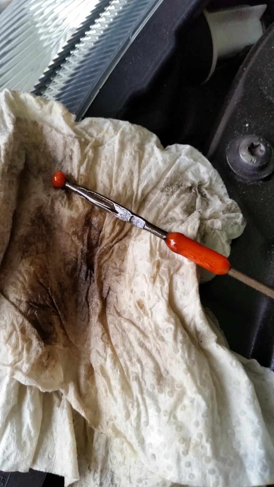

Also i checked the oil level after i had been for a drive (car had been stood for a good 15 mins before checking) and the oil level seems really high! She has just had a service at skoda (less than 700 miles ago) so i would expect the oil level to be correct but its up to the round orange bit on the dipstick (if that makes sense?)
I know over filling can cause damage on some cars so im after some advice as to what to do next??

Reading the oil level is abit different on a vrs to 'some cars'.

Dip it cold this morning if the car is on the flat.
The oil 'should not be higher' than between the top of the cross hatch and the top orange marker.
So above half way between and someone has put 3.9 litres of oil in likely.  (The capacity is 3.6 litres, i put in 4 litres of 5w 40 FS VW502 00)
Open the drivers door, put the key in and start the engine. stop it right away.
Dip the oil.   It might be just at the top of the cross hatch.    That shows the same as a Hot Check.
You get a hot check running the car for at least 10 miles and the oil at around an indicated 80*oC.
Stop and wait 4 or 5 minutes and dip it.   (The manual says a few minutes, that is not 15 or so.)
Anyway hopefully the oil is at the top of the cross hatch with a Hot Check.
If the Oil is higher than that go ask at the dealership what the technician used for Oil and how much oil they put in.
it might have been 4.2 litres and they need to take out oil. & sign a letter to you that they over filled it.

Not my picture, taken from Google Images.  Crap Dip Sticks to read though, especially with clean new oil.
Cold dips make sense if you know how much oil you put in at the service.
Then you can check before going on a trip or starting a journey, not once moving and getting oil up to operating temperature. 'Simply Clever'.
*The oil cold without the engine started should not be on the round bar above the stamped area in a 1.4 TSI Twincharger.*

Right i dipped it this afternoon COLD and here is the result:
14585581_1146114435480940_1092962632_o.j
Then i thought my drive isnt completely flat so i moved the car to the road (about 20ft) and dipped again but couldn't see any oil so i added about 3-500ml of oil and it then showed this:
14614296_1146114452147605_216494442_o.jp
I then went for a 10 mile drive, the oil warmed up and got to 89*c, i then pulled up at home let it sit for about 4 mins and dipped again:
14614275_1146114488814268_1513002605_o.j
So im now thinking that the oil may be too low! but if it was serviced less than 800 miles ago there is no way i could have used that much surely? The car has always been serviced by Skoda and has full service history and is on 43800 miles.

OK.   & they probably used 5w 30 FS Long Life oil (VW504 00)
Some engines do use oil for a bit after an oil change.
There can be a drop and then it just settles to maybe a top up on occasion or uses none.
So do not overfil.  If on a cold dip you have oil to just above the top of the cross hatch that is fine.
