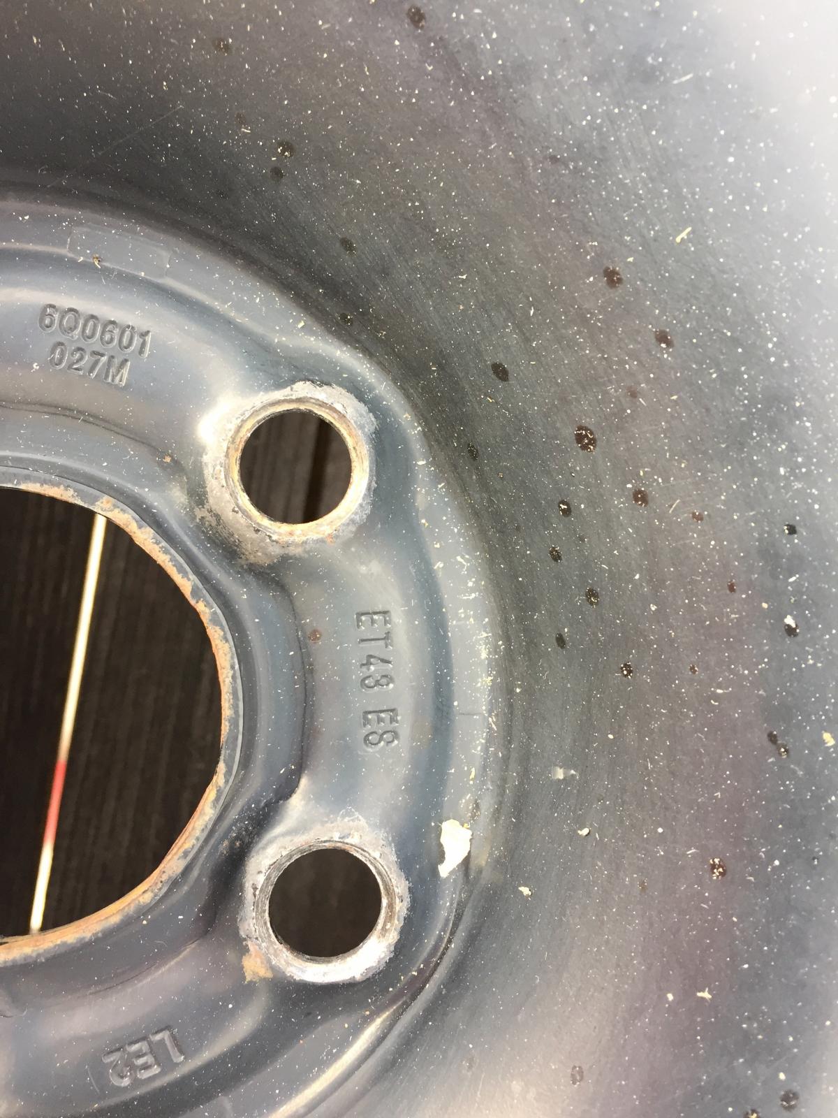

Hi DrWho. By any chance are you looking at wheels / tyres for sale by wilfthewolf? If so I'm looking into your question as it's me selling them. They were sold to me as the right wheels for our Roomster Scout by a Skoda dealer so should be right. The only issue I had was that originally I had 195 tyres on, but they were approved for every model other than the Scout so I had to put the 185 tyres on to make sure it was an approved combination. I'll dig out the data (I think it came from ELSAWIN) and confirm, even if its not you asking.
Oh and I've just looked at the information and realised the listing is wrong and they are 43 offset.  I have a photo of the marking on a wheel so will add it here if I can, and amend the listing.
