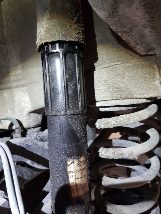

in case Škoda can't find reason of rattles in more than 10 attempts
i have made visit to independent service - Volkswagen dealer "Moller Auto Krasta"
they told problem sounds exactly same as they have heard with Passats 2015 until shock absorbers
3Q0413031BE PR-G09
were replaced by
3Q0413031BE PR-G06;G11
i have found also confirmation in public documents:
http://www.realoem.me/Volkswagen/BR/PA/2016/793/R/4/411/411010
interesting ..BE PR-G09 still in use for Superbs, and there any word about recall
http://www.realoem.me/Skoda/CZ/SUP/2016/851/R/4/411/411011
but my car got another
3Q0413031AK PR-G04
there also any word about recall or possible replacement
http://www.realoem.me/Skoda/CZ/SUP/2016/851/R/4/411/411010
dealer rejected replacement cause rattles aren't problem and no leaks detected
