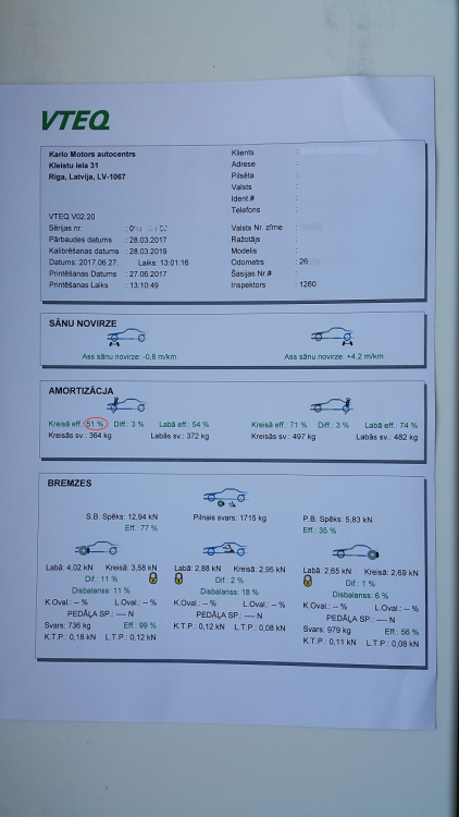

two weeks later at annual service, dealer gave me printout(and charged for test)
where is clearly debt, shock absorbers are almost as new - with efficiency 51% 54% 71% 74%
by my feeling they are exactly same from the first day
