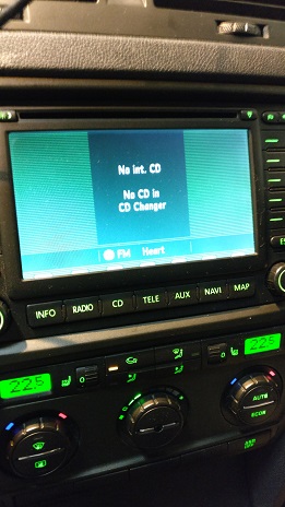

After disconnect the battery of my O2 for 2 weeks now my CD changer doesn't work and I get message on the screen of HU "No Int.CD" post-126085-0-19460700-1477407827_thumb.jpg
I thought CD is gone so I buy another working one (second hand). Same result. So it is not the CD Changer. Must be something else, but what... Any advise?

Before disconnect the battery everything worked. I thought the Cd changer unit is gone and that's why I've order another cd changer. The changer and the HU load, eject without any issues. Just doesn't play anything and I have that message on the display.

there is a light in the dark. Yesterday I disconnect and connect the battery as same manner as I did it before. Turn on the engine and turn on the radio. First I saw on the screen for less than a second the menu where the system ask you for PIN code-obviously the computer remembers the code. Radio start smooth working. Press the button CD and  cd disc played music for let's say about 25 sec. Error and system change to radio. Press CD button, played music from the cd for 1:30min then I decide to increase the volume and again the system error changed to Radio mode. Press again CD starts for 1 sec and on the screen shows me Track 80 and time like 8hours?!?? Changed to radio, press CD button , CD played music for a second or two , changed to radio - and that exercise repeat several times until it said NO Int.CD.

There is something else since today. If the volume on the radio is up to 4, than CD is working without problem. Increase the volume and CD stops straight away :(
Therein lies a problem - the radio doesn't sound as if it is communicating with the rest of the car. if it was, it would pick up the PIN code from the instrument cluster (codes are stored there so they don't need inputting after the battery is disconnecting)
If it is asking for a code, then it cannot retrieve the code that is already stored in the car's instrument cluster, and this is a sign that the internal memory of the head unit is failing or has failed. You could really do with a full VCDS scan to see of there are any fault codes stored in the radio and other modules. I would suspect that there would be communication errors in a couple of areas.
In all honesty with a Nexus unit it really isn't worth messing about with. It will have come to the end of its useful lifespan and I would strongly susjest looking at replacing it for a better Columbus unit (if you want to retain the sat nav) or a Bolero (without nav). I don't think anyone would disagree with me when I say that a portable TomTom or Garmin is a way superior navigation than a Nexus, and that the Nexus won't be missed.
