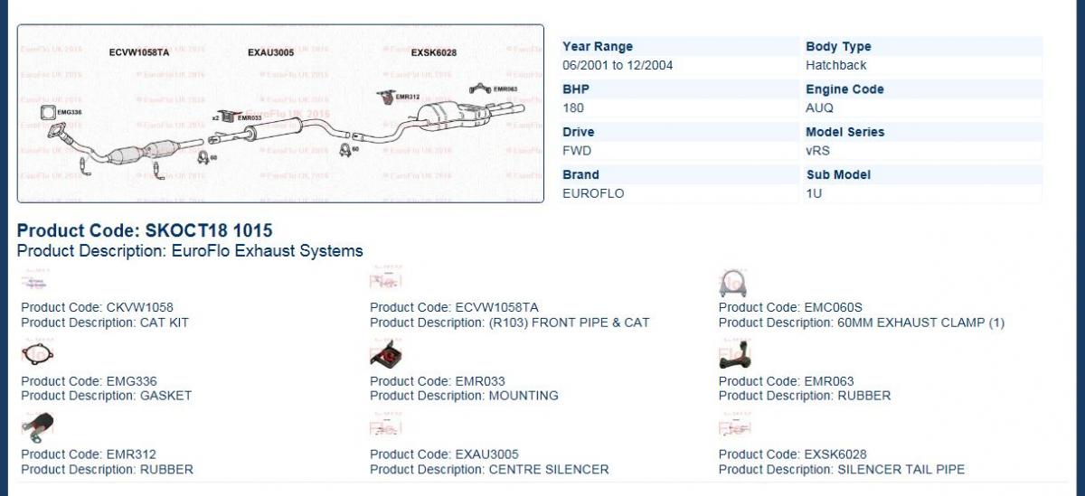

EuroFlo do list a rear box, part number EXSK6028
Screen grab from their web cat
Thanks guys, Ive checked out Euroflo but cant seem to get a quote on the back box.
I'm thinking universal may work out cheaper but although I wouldn't mind it being a bit louder I don't want it really noisy.
