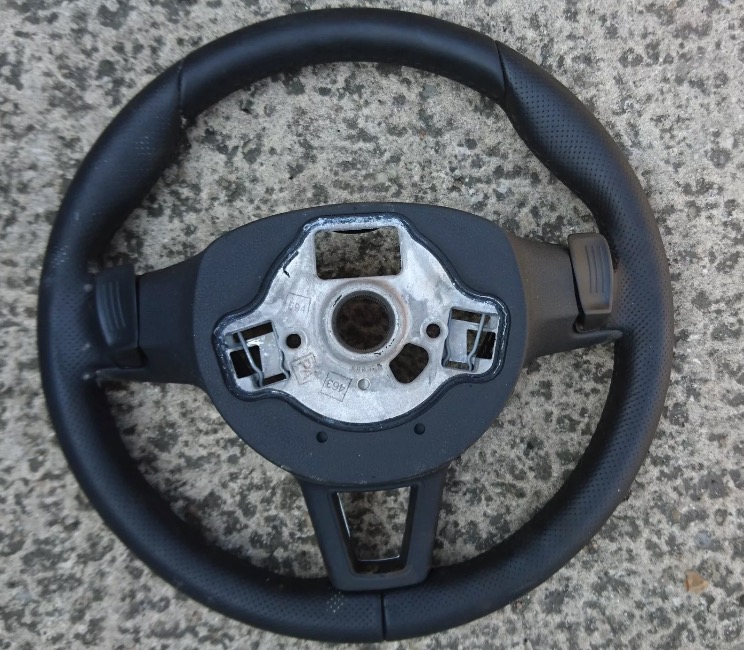

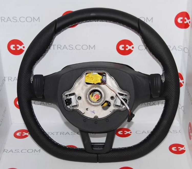

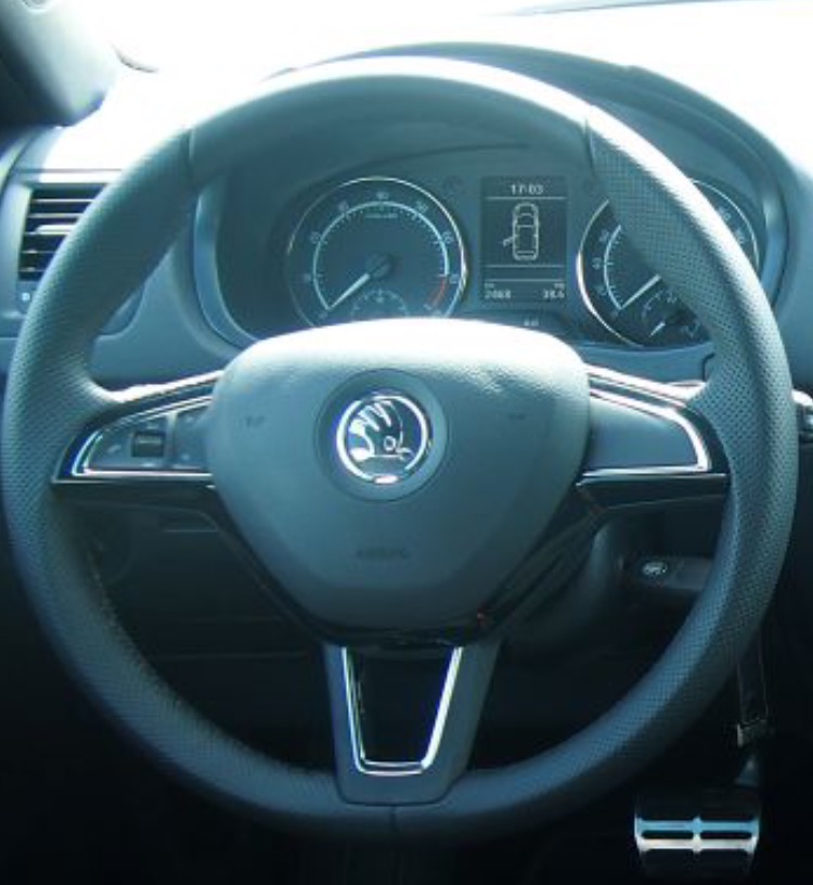

Steering wheel Octavia RS in Fabia rs

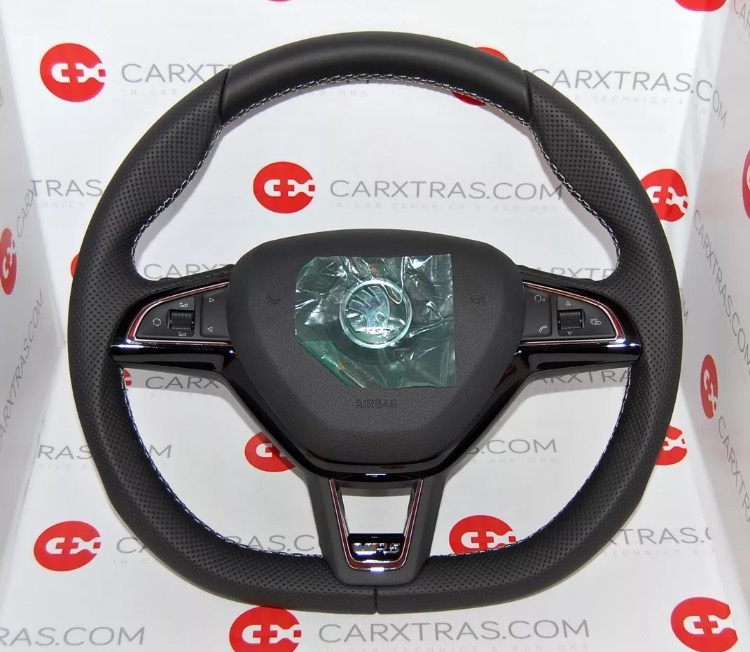

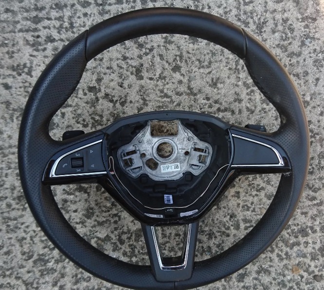

Can you use the steering wheel of the Skoda Octavia RS 2017 for the Fabia RS 5j?
Fabia rs:
Octavia rs:

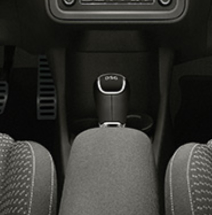

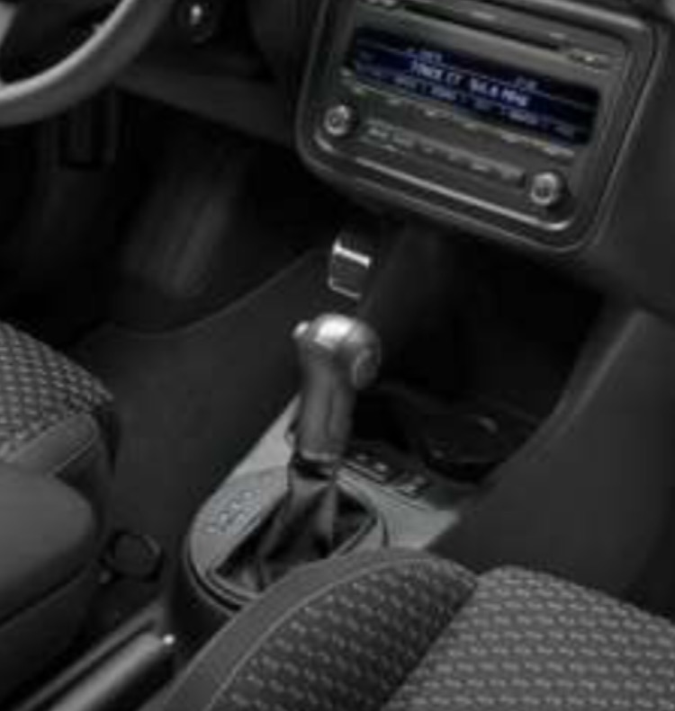

And can you use the DSG change lever of the Fabia RS 2013 at the Fabia 2012?
2012 :
2013:

I have DSG ;) , but thanks
The paddles only plug in though. Dont think it makes much difference. If some of it works id think the dsg buttons would.

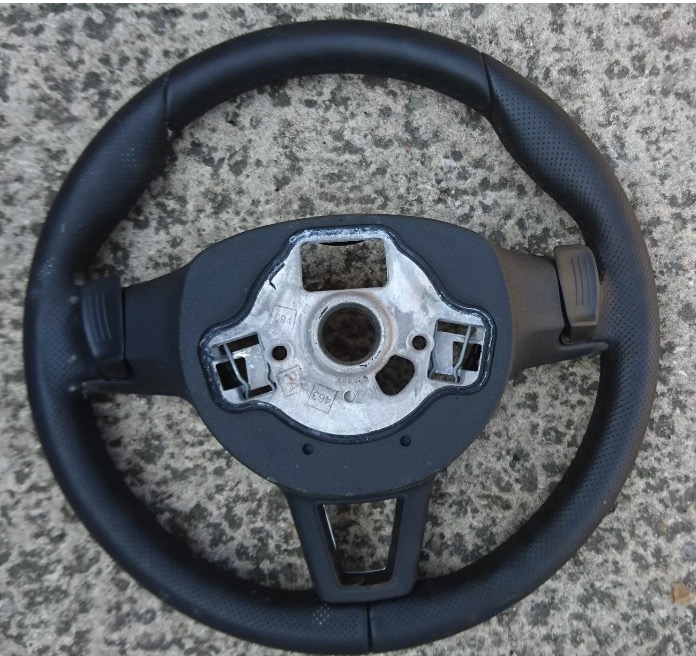

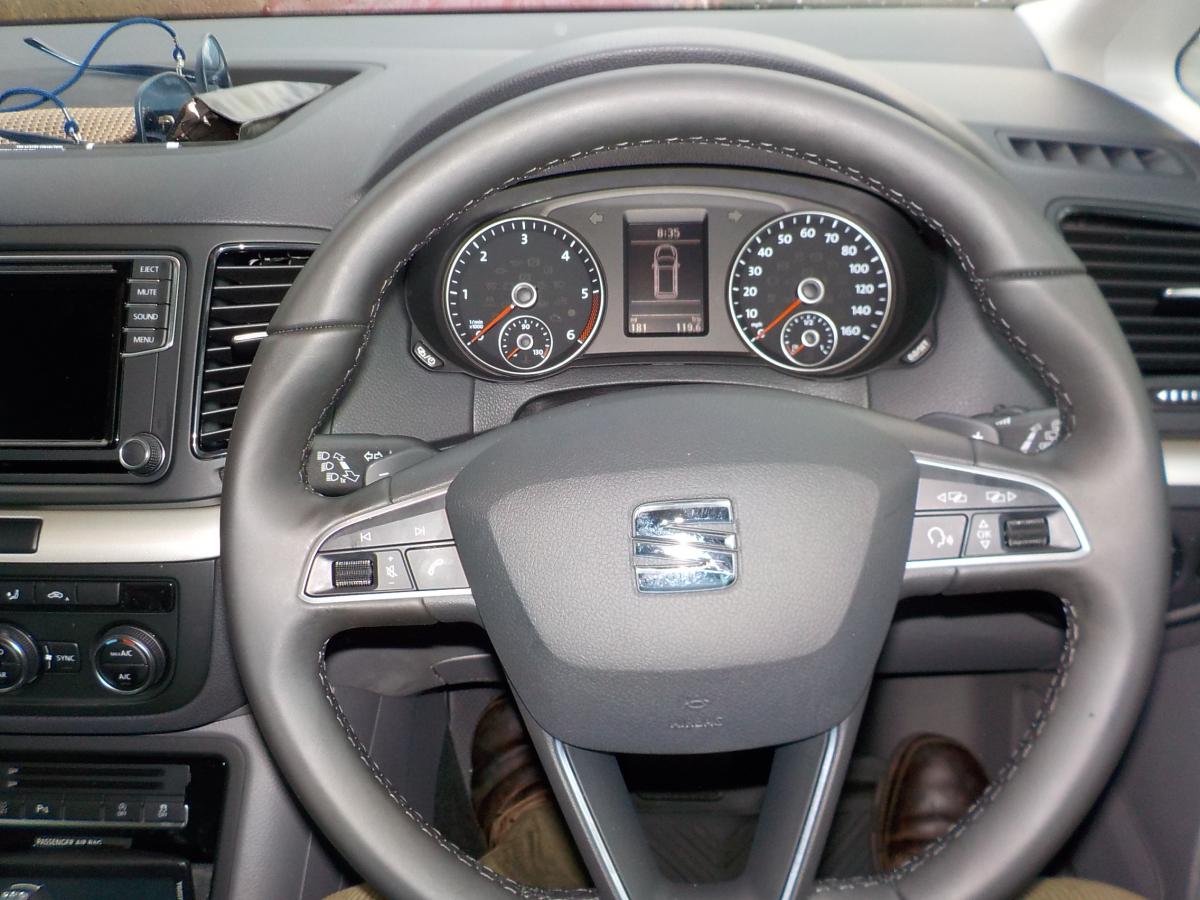

Fabia RS mk1 5j:
post-113535-0-39482100-1479485238_thumb.jpgpost-113535-0-99212100-1479485299_thumb.pngpost-113535-0-85891400-1479485310_thumb.png

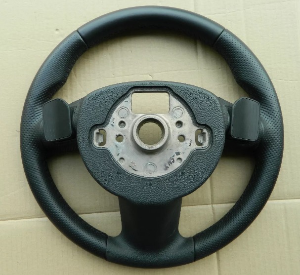

Fabia RS mk2 5j:
post-113535-0-00640400-1479485342_thumb.pngpost-113535-0-25605800-1479485350_thumb.pngpost-113535-0-72829600-1479485357_thumb.png

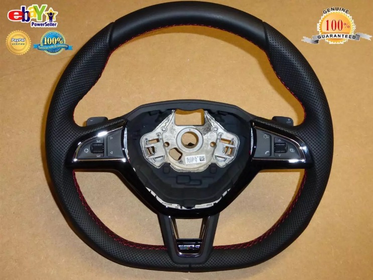

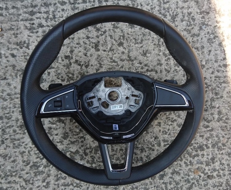

Octavia RS 2016:
post-113535-0-55788000-1479485370_thumb.pngpost-113535-0-08981800-1479485393_thumb.pngpost-113535-0-21605800-1479485402_thumb.png
Which are compatible with Fabia RS mk1? The steering wheel of the Octavia has the couplings and the module of the airbag identical to the one of the Fabia

The latest Octavia uses a different protocol for the buttons. They won't work with the 5J. You'll need the buttons from a facelift (2014-) Superb which I think were also on the Yeti of a similar age.
so the Octy wheel will work as long as the buttons are replaced with Superb/yeti buttons with all the MFD working aswel as the paddles?
