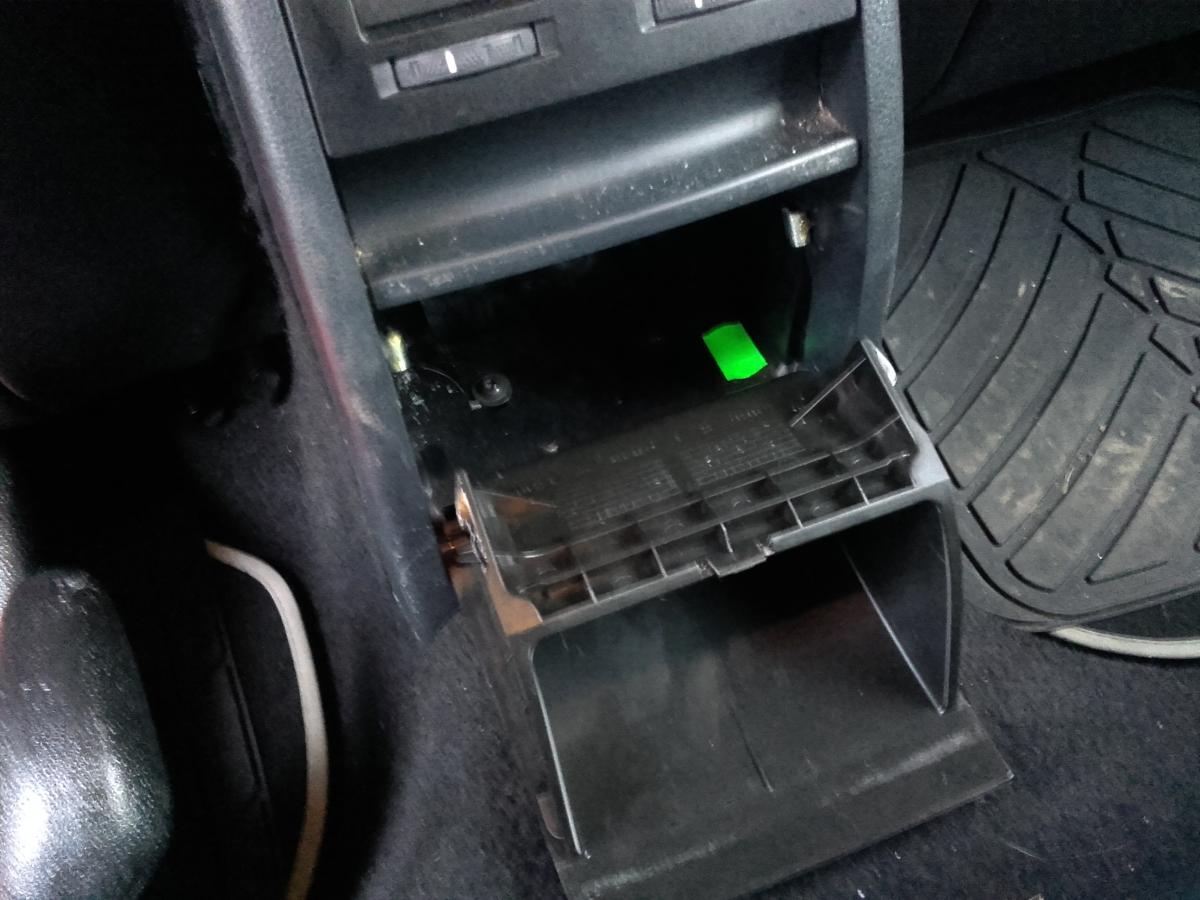

Seen a few folk asking how to adjust handbrake cable at handbrake end. The adjuster is under the console. If yo have the wee bin that opens on the back end open it and the bin pulls up out of the carrier. The actual carrier will then pull back with a fair tug and hinge out of the way  This will reveall the 10mm adjuster nut. So no need to remove the whole console.
Top tip. I am sure this will be useful in the future.
