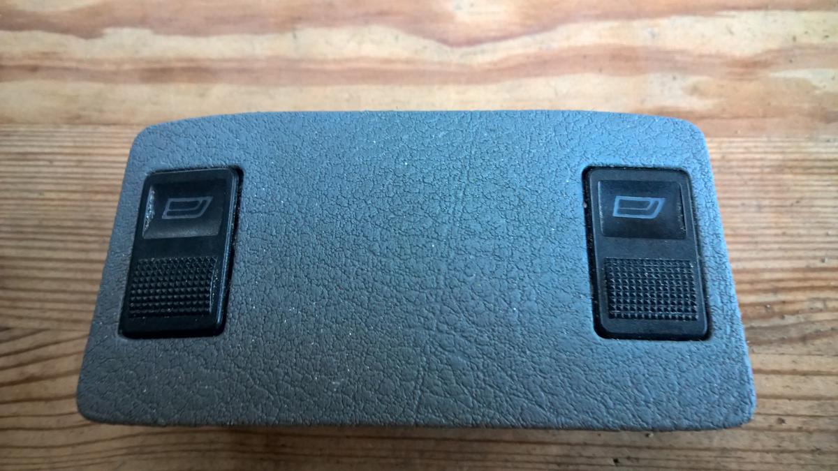

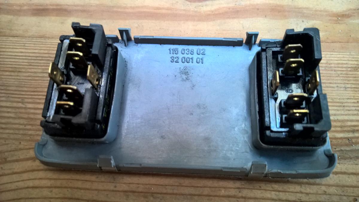

Seems like one of the switches for the drivers side window has broken can I get another? or adapt another?   here are a couple of pics... I cant get them out of the plastic surround at the moment  in case I totally wreck them....so any advice would be good....John

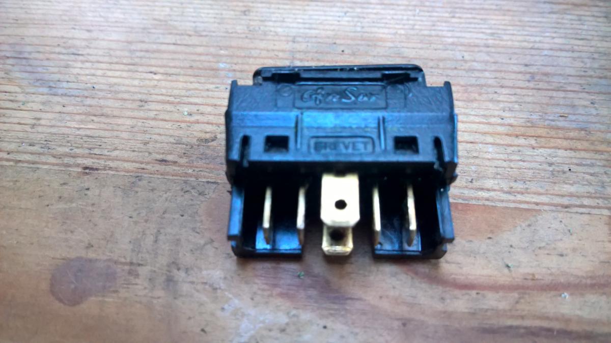

Ok I got the offending switch out....looks like this
Hi there it's a after market skoda switch but you can use a audi 80 switch 5 pin but your need to add two relays to make work with the window
Hi Uma 1998, thanks for the info...... not too sure about the relay wiring, electrics are not my strong point  regards  john
I will have a dig out after Christma period in the felicia parts as I can't remember if I have a spares...
