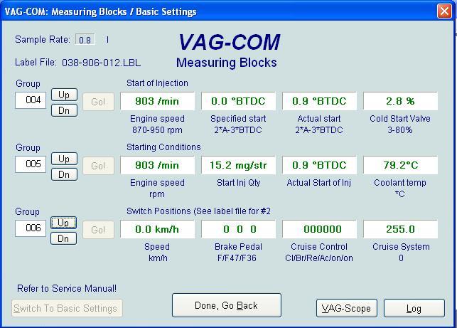

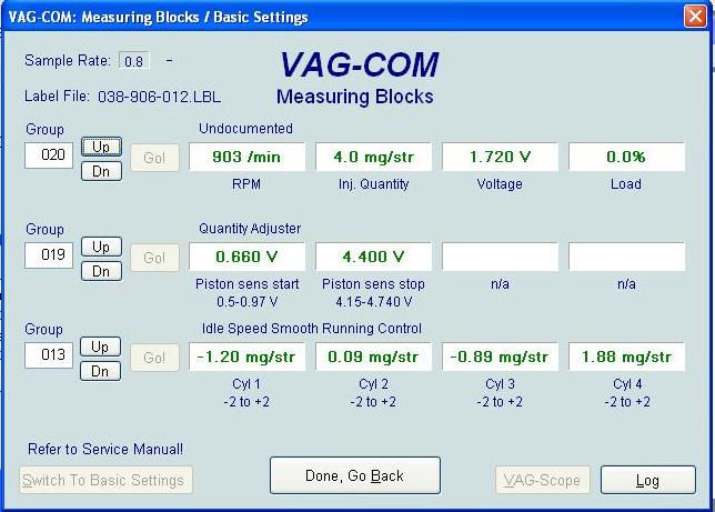

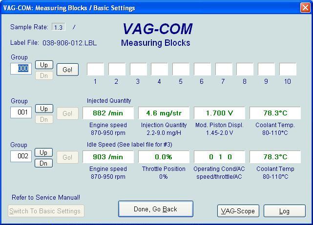

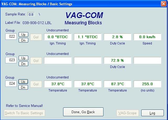

OK, I'm very stuck with all this now.
I have managed to get a couple of readings of Vag-Com and they do not look good to me at all, I could really do with some advice!
I have attached a couple of images from the readings I thought relevant having read around.
Any help, advice or things to try much appreciated!
check that the exhaust is not clogged
Check that the air filter is clean and that it's warming up properly, if not replace the thermostat then the ECT sensor and maybe the fuel temperature sensor as required. The cat may be clogged due to the previous owner using it as a shopping trolley, motorway miles will clean it up.
How does the timing check out on the scope? Could be sticking egr valve possibly
What colour is the smoke?
Thanks for all the advice.

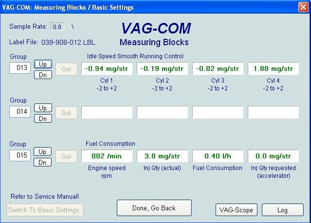

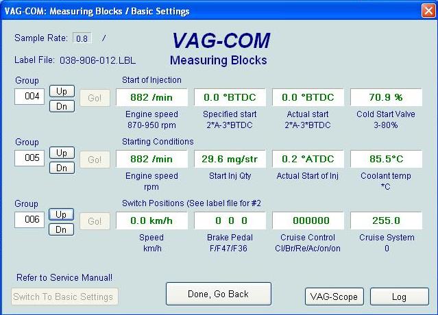

I found the timing was out, so got that altered as part of getting the cambelt replaced as it was due in the next 6 months. This has produced some good results, it's not as smokey and seems to be nice and quiet bar on of the injectors!
Next step is to replace the injector on Cylinder 4 as it looks out compared to all the others and I'm still getting smoke under acceleration although not as bad as before the timing was adjusted.
Any one any advice on how to remove and re-fit an SDi injector. All the bits I read its a special tool to remove but nothing on how to replace.
Have attached a new timing reading and also injector readout.
