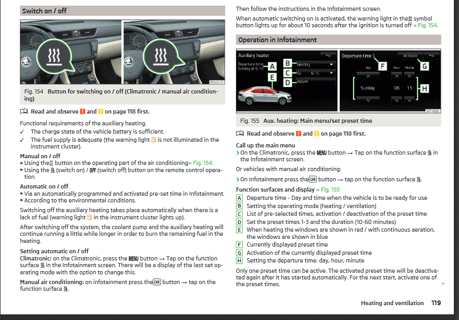

If you look at page 119 - http://ws.skoda-auto.com/OwnersManualService/Data/en/Superb_3V/11-2016/Manual/Superb/B8_Superb_OwnersManual.pdf do you have the button on the climate control panel like so ?
Thank you Rick TT I think you are right and the car doesn't have it. Not a good start is it, hardly fills you with confidence when they give you something for your car when it doesn't even have it ???? thanks anyway
