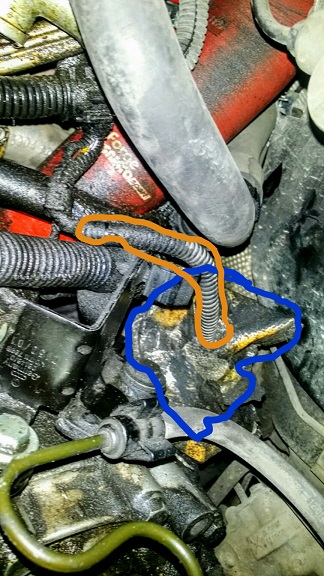

in the blue is the blanket I was talking about.
The orange is what I tried to put into that clip(it was already out).  I did not manage to open it and just left it as you see it.
