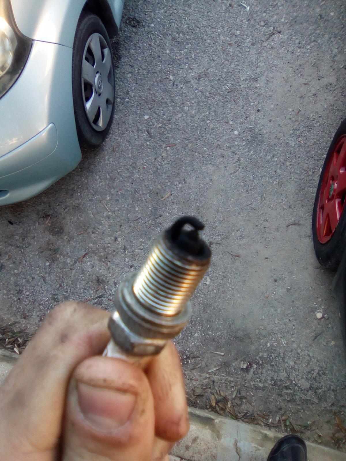

Could you stop it after 30s, pull the spark plugs and post a photo?
I will do that on sunday when im not working, how shall i adjust the choke for cold weather? Here its not so cold, it goes to about 10 degrees celcius. Right now its adjusted with a fast idle of 1800 rpm, and it lasts till about 5 minutes, pull off is working, it opens about 4mm i dont know exactly

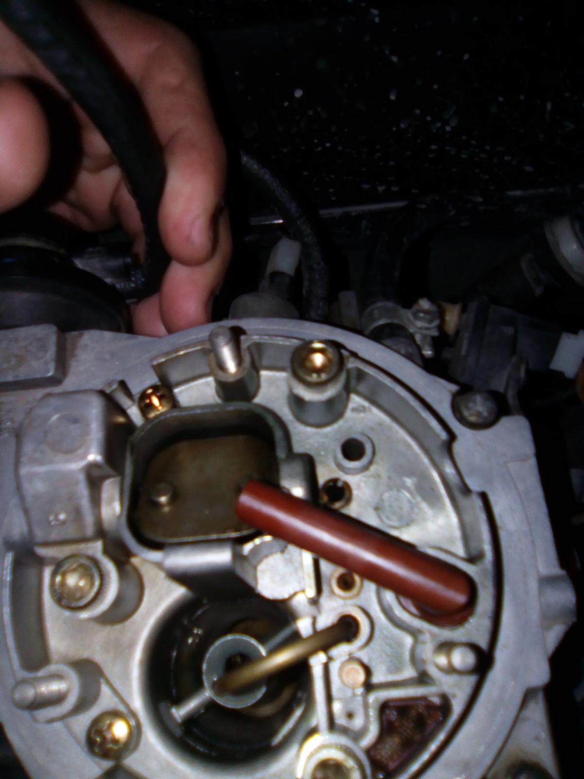

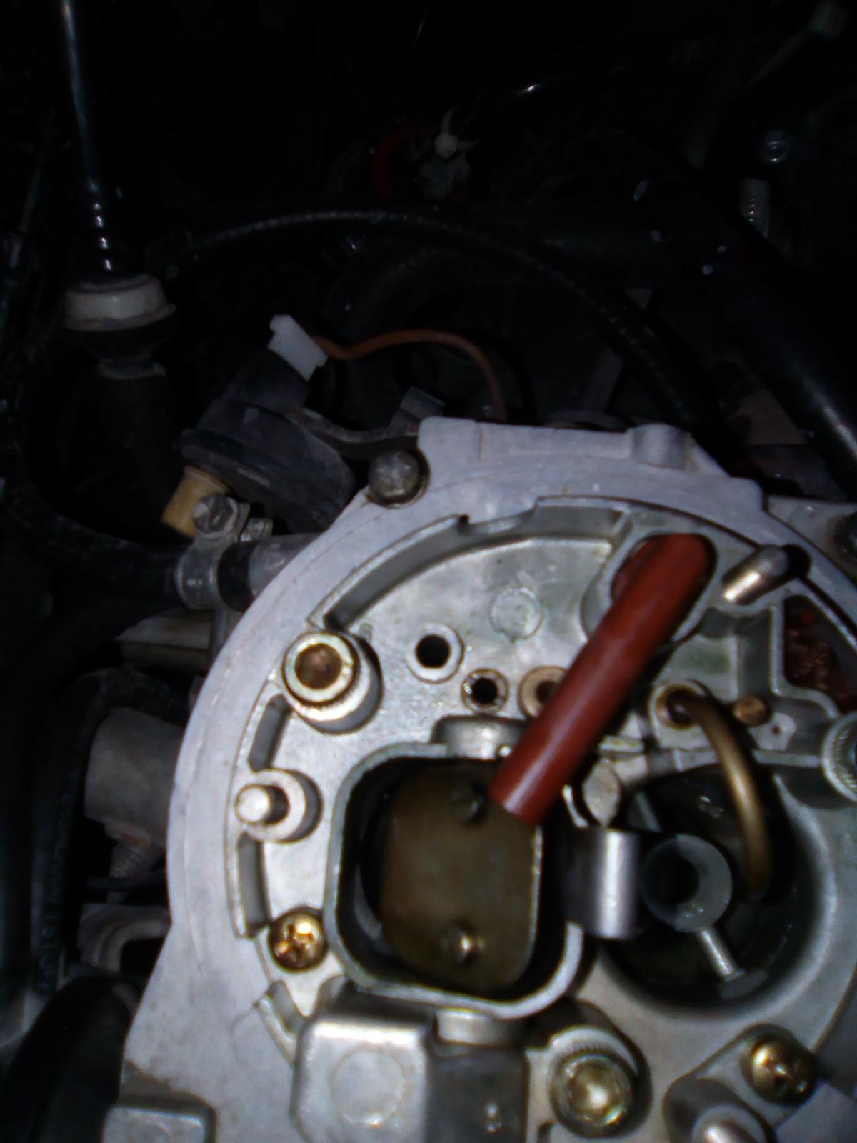

These photos show my first stave of pull down a d the second stage of pull downpost-114994-0-99283400-1482520513_thumb.jpgpost-114994-0-81305300-1482520531_thumb.jpg
Today from cold start the choke flap barely moved or nothing at all, but i tested the pull off, i sucked on it its holding vacuum
Started the car this morning, it started ok today but the choke flap didnt move at all
This is looking more and more like my original suspicion, that the auto choke isn't working correctly.

This is this morning after running the engine for 30 seconds after startup

It did the same with another known good autochoke, i think its the pull off unit, it not opening the choke flap, or if opening, it opens a minimum amount only
That is exactly the role of the pull-down unit. To open the choke flap 2 mm in cold weather.
