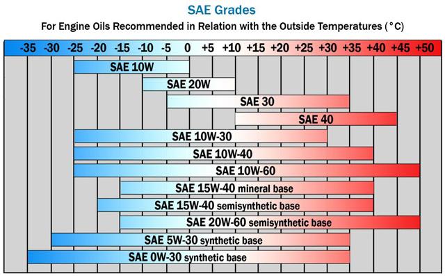

In cold climates it is important to have fresh engine oil suitable for winter season (like SAE5W-50). The battery capacity will drop in freezing cold temperatures, so use a home charger regularily to have the battery fully charged. Check the anti-freeze so it will cope with the actual temperatures.

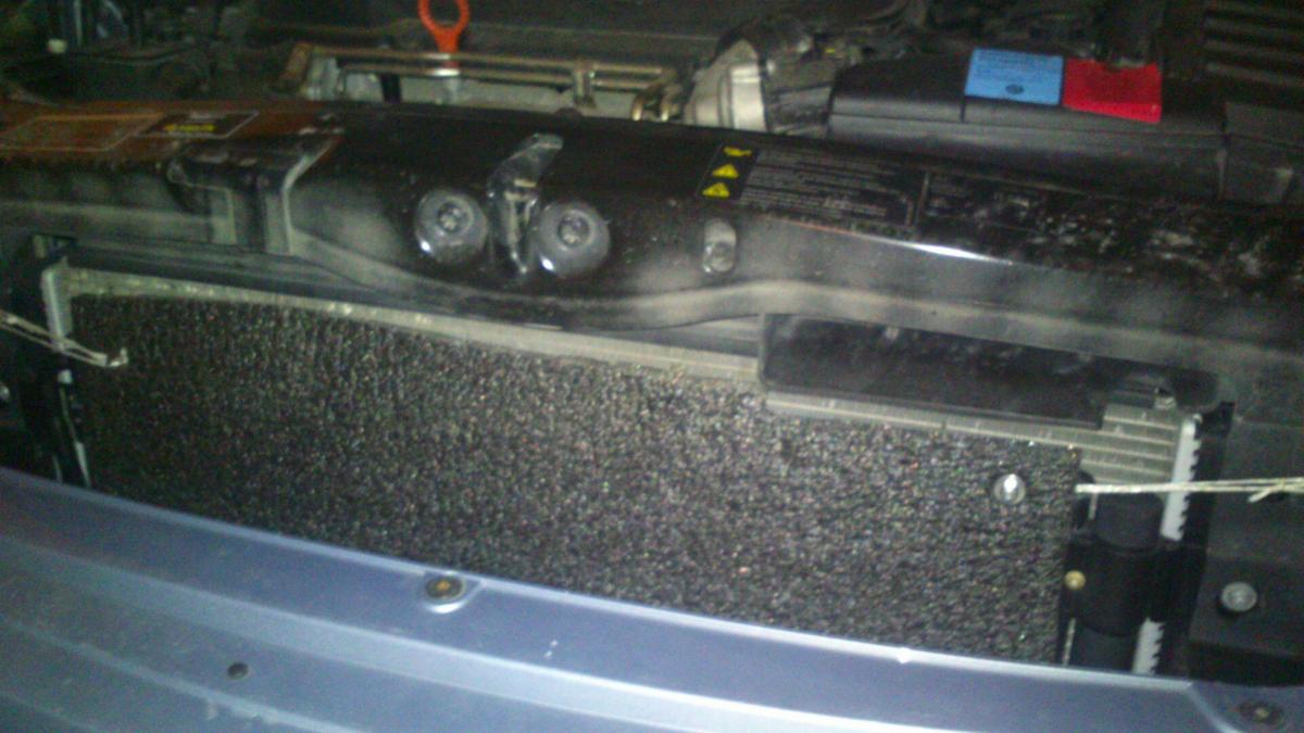

I have used some covers in front of the grille or directly on the radiator to reduce the cold air stream to the engine bay. It reduces warm up time for the engine and interior. The size can be adjusted to the temperatures you have, but it is no problem to cover half the radiator. Just keep an eye on the temperature gauge, and reduce size/remove if temperature rises.post-123248-0-39607100-1483889563_thumb.jpg
In cold climates it is important to have fresh engine oil suitable for winter season (like SAE5W-50)[/url]
5w-50??? Dont be daft. You need 0w30 if temperatures dip below -20deg C regularly. 5w30 is good to around -30 deg iirc, but a 0w oil would flow easier at that temp and cause less damage due to poor circulation, which was probably the Honda's problem.
Anyone who lives in Poland would know that cold snaps to below -20 deg are not uncommon in winter in parts (its a big country).
Started my 98 Alhambra tdi after stood in -23 deg C for 2 days whilst in
Poland a few years back. No problem, but glow plug light took well over 10 seconds to go out instead of the normal 1 second.
Yes, SAE 0W-XX will flow a little better at low temperatures like -30 and is set to cope down to -35 deg C. But bear in mind that the given limits are for consistent temperatures, if temperatures stays that low for a longer period. No need to go bananas, it is not Arctic temperatures the OP talking about. OP said that worst is -5 to -10 deg C, and rarely goes down to -20 C. Then a SAE 5W-xx is suited.
Another thing is to check the oil requirements from VAG for the engine in question.
