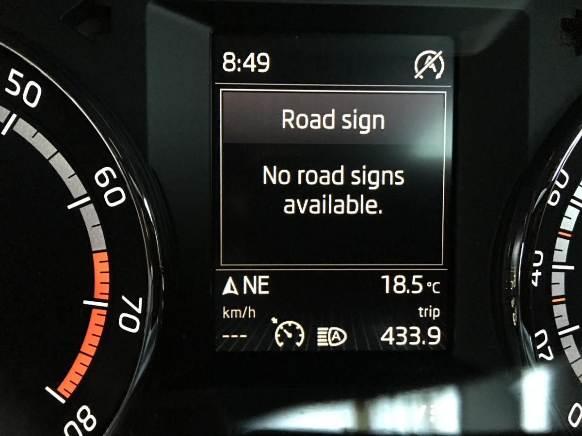

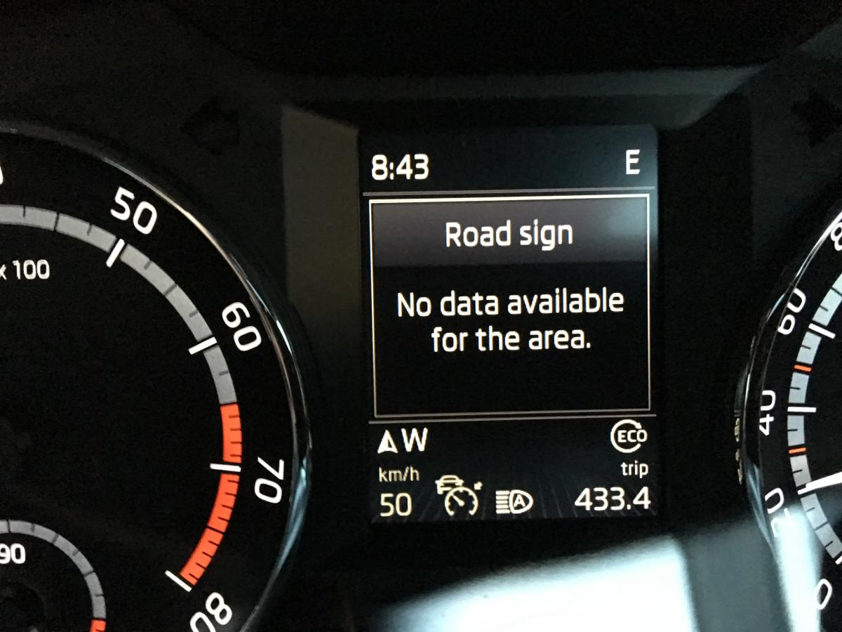

Has anyone tried to enable TRS in New Zealand? I've just tried on mine, all but the last coding (long coding in 17) is accepted, it comes up with an error coding 17, then when driving it says either "No data available for the area" or "No road signs available".
I assume I don't need to be navigating anywhere for it to display road signs?

Yeah I passed quite a few which it should have recognised but didn't.
Looking at the dials it seems to have accepted the coding as it's moved the Compass from the top middle on the Maxidot to the bottom left. same as mine did.
What I reckon is that it needs to know what a sign looks like in order to recognise it (based on GPS location), and there are no road signs in the database for NZ. I wonder if anyone can confirm.

Unless i've miss understood your last post the GPS location doesn't operate the TSR, it's the Lane assist camera.
Drop Andyvee a PM you might have missed something.
Sounds like the same issue I had in Australia. The system knows where it can be used so refuses to work correctly. You can kind of get around it by making the system only use the cameras and not the Nav database as well. I started a thread in the Octavia forums on vwwatercooled.com.au a couple of months ago.

Also, I noticed in your first picture that you have 'Eco' in the maxidot. I've not seen that on mine. Does it only show Eco or does it also show the other driving modes? My RS only shows them in the top left of the main infotainment screen.
My RS shows Eco - but not the other driving modes.
The Eco symbol only displays when you are coasting and the DSG has disengaged.  If you are either on-throttle OR on-brake, the clutches engage again and the symbol disappears.
I suspect you've never noticed it display, if you don't "coast" too often?
Ah. mine's a manual - I guess that's the difference.
