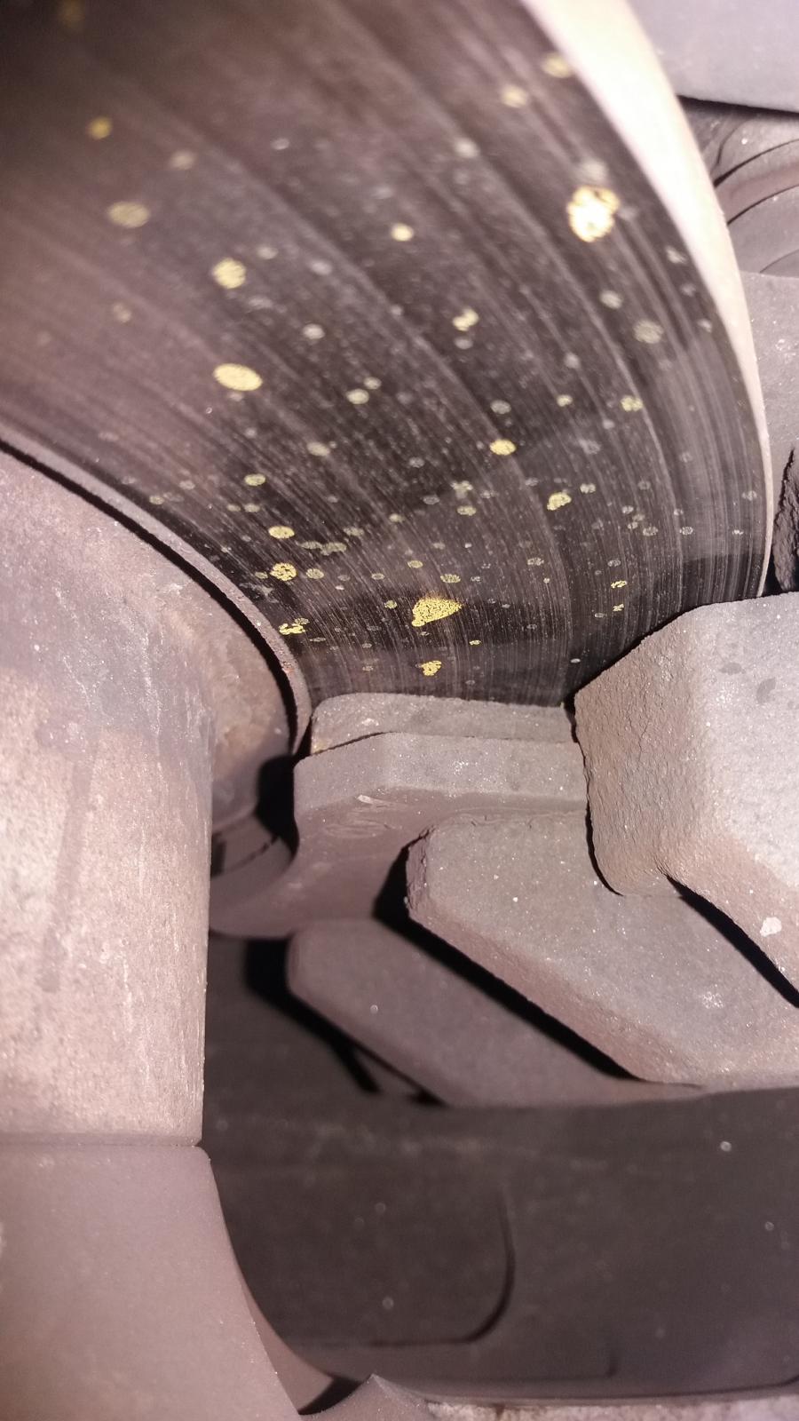

Again the first garage - said car brakes don't have to be bled - told me they would change brake shoe's..
I've added a picture..  I don't think they need changing.  The brake's work fine but for a slight spongy feeling if I keep pushing them.
The dealer I got the car from did the cam and water pump and also put new pads on the front only 5k ago.

I wouldnt use Kwik Fit for any work. Those pads look fine but what are the inside pads like? They do tend to wear a bit quicker on the inside. I would rather pay skoda or vw to change the brake fluid or a decent vw specialist.
