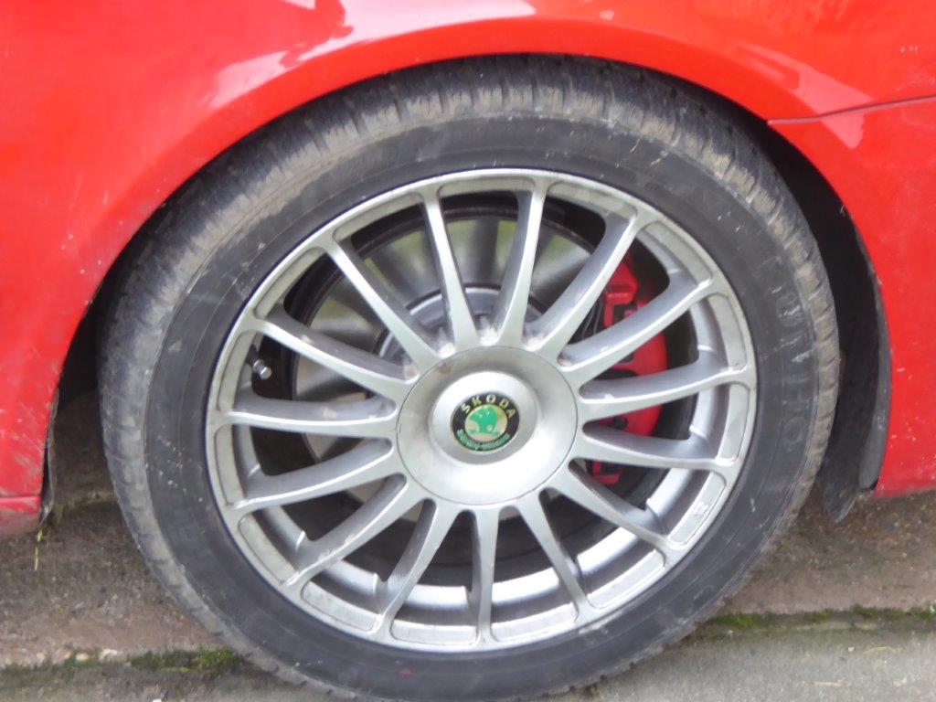

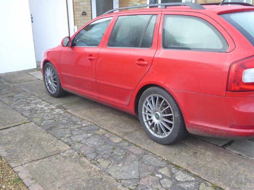

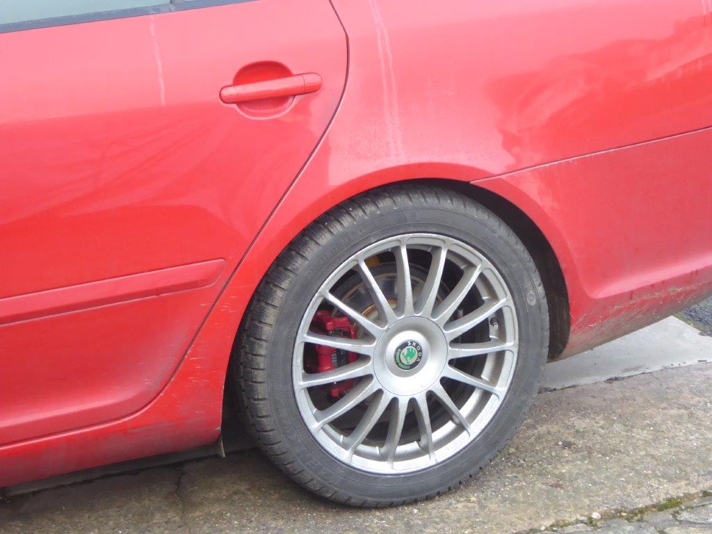

post-24054-0-96280900-1484912002_thumb.jpgpost-24054-0-51035500-1484912018_thumb.jpgpost-24054-0-09687700-1484912030_thumb.jpg
I have Eibach Pro Kit springs fitted.
It drops about 20mm for the vrs, more will give you problems.
The ride is much better not so harsh as standard.
Hope this helps.

attachicon.gif P1030993.jpgattachicon.gifP1030994.jpgattachicon.gifP1030996.jpg
Hope this helps.
I forgot the pictures show it on it's winter wheels and tyre 225-45-17 Rimstock Monza R wheels.
