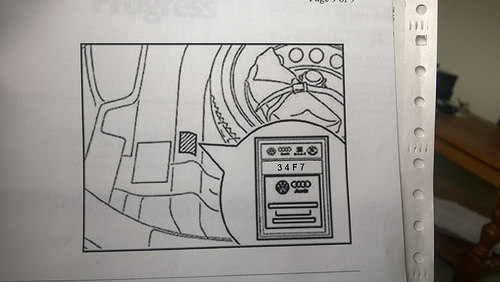

Hi,
Just checked the boot for the sticker and can't find anything regards to it, if I can upload I'll attached a photo of the only sticker. I can recall skoda carrying out the DSG oil replacement under the recall. Tell ya what I wish I never went in the boot I found a pool of water in the well ????.

The DSG Service campaign sticker would be next to the VIN sticker/  34F7  /   Who should have done that work?  Check with Skoda UK Customer Services
if on the system for Service Schedule, Warranty & Recall Actions as done and paid for by Skoda UK.
