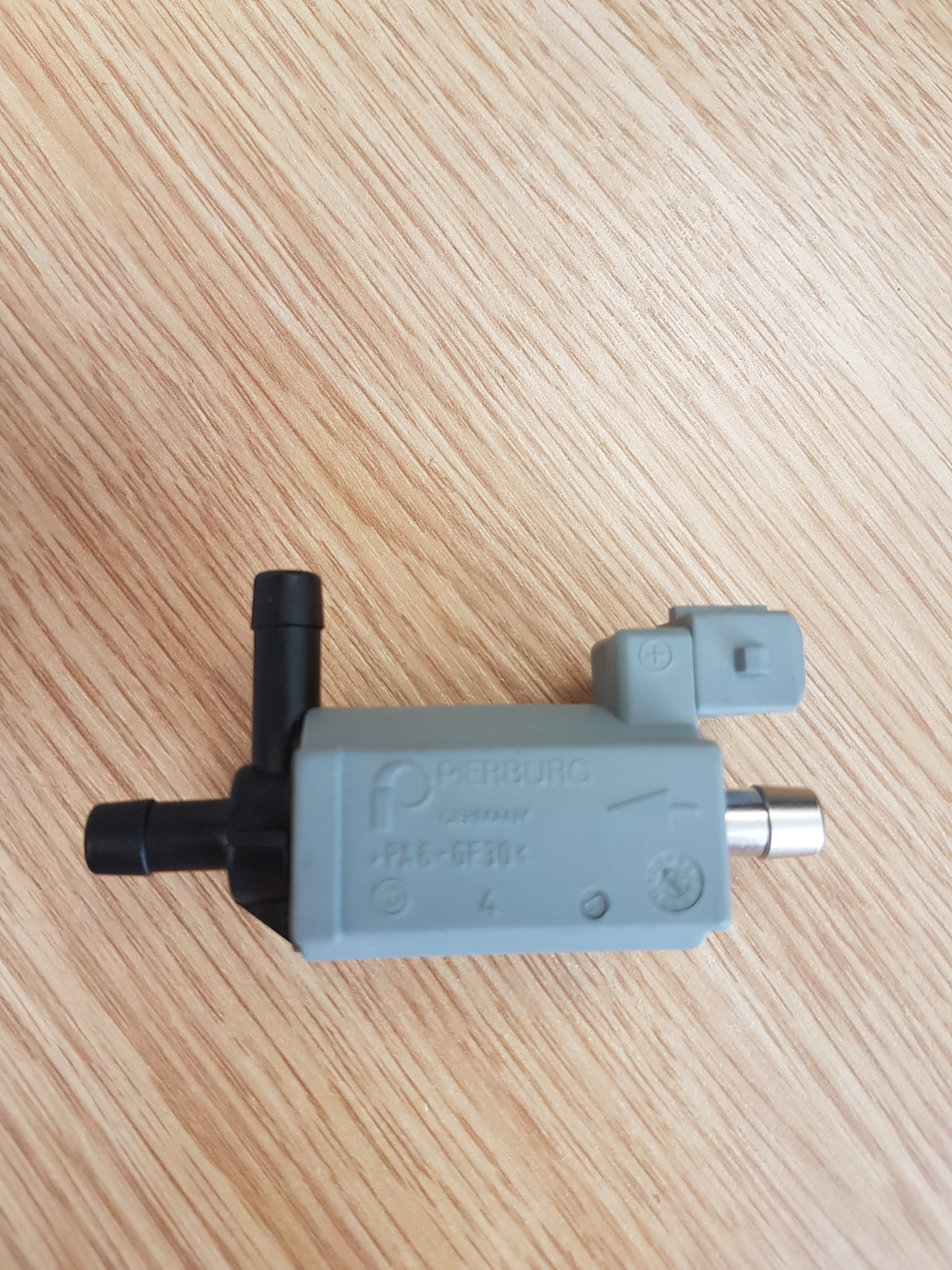

I seem to lose power under acceleration at around 75/80 MPH. After a bit of research it would appear the common theme is a dodgy N75 valve.  So I've bought a replacement but it is drastically different from what is fitted at the moment.  What I need to know is which inlets/outlets fit to which part? E.g waste gate actuator, airbox etc.  Cheers

That looks like an N249 valve to me not an N75.
N75's look like this...
