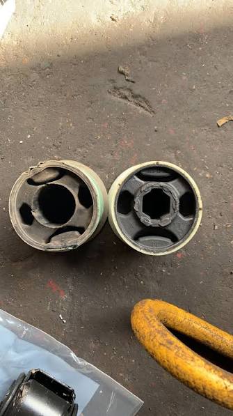

Hi Got to change my sons front consul bushes on his mk1 1.2htp and the old bushes are so worn so not sure which way new ones fit. I think the narrow slotted section in rubber is vertical and hex section has to be horizontal but they are offset so is it the narrower side or thicker side that is nearest engine. Photo from internet as example and his are about the same.

If your Febi bushes have this lump like the OEM ones, the lump should be on the side nearest the midline of the car.

Cheers pete They do have the bump and I got the tool a while ago. Just never got round to doing them as they werent too bad at the time. MOT soon and reckon its a fail this time as ones knocking slightly and as I already have all parts including new arms might as well do it. Didnt realise had to lift engine but have a cross beam lift as I did the clutch a while back so shouldnt be too difficult. I assume I have to remove engine support and maybe dogbone?
