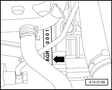

You might also find a sticker on the cambelt cover or if you look at the joint between the engine & gearbox the code letters are etched into the engine as shown in this picture
