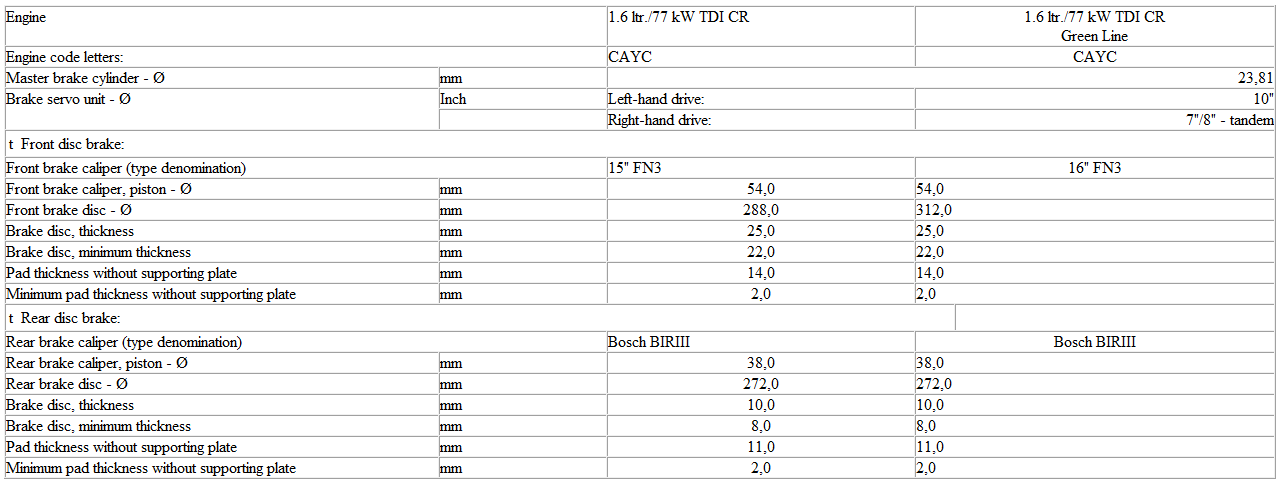

This is what the workshop manual says about the 1.6 TDI.  The fact that I'm not 100% sure it's a Greenline doesn't help.

My 2011 Greenline Estate has 312's in the front and 272's in the back. According to the Brembo Parts catalogue, all 1.6's have 312's in the front, but there are three sizes for the rear (256, 272 and 282).

They were 312's.  I could see them clearly behind the wheels so was handy enough to estimate the diameter without taking the wheel off.  Ordered a pair of ATE discs for €96 with free delivery from Mister-Auto.  Not too bad.
