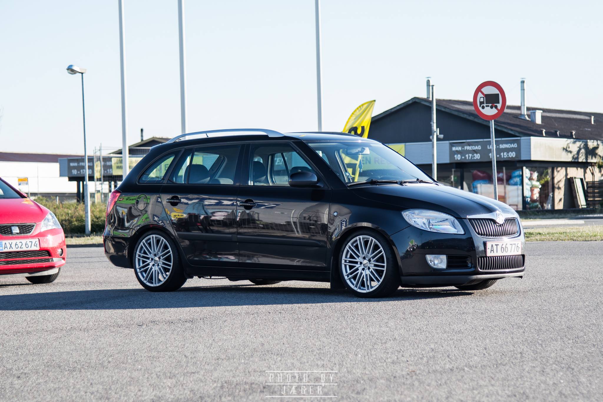

Hey! i have bougt a set of 17x7.5 ET35 & 17x8.5 ET35 wheels, my fabia is lowered, what size tyres should i fit on the rear to be sure there is no rubbing?, I had 17x7.5 ET35 with 205/40 all way round with no problems :)
Some pics of the car!
http://imgur.com/a/MQAzs
