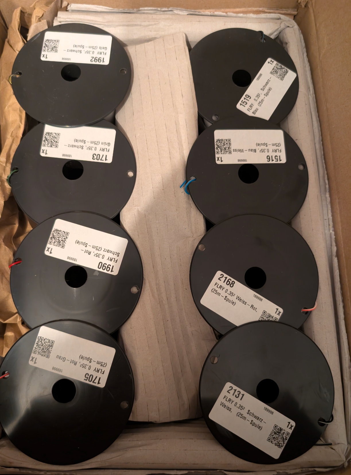

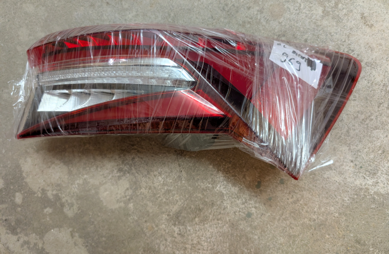

First Material
The next parts for the conversion are arriving...
The next parts have arrived... connectors and pins for wiring, the set of taillights is complete...

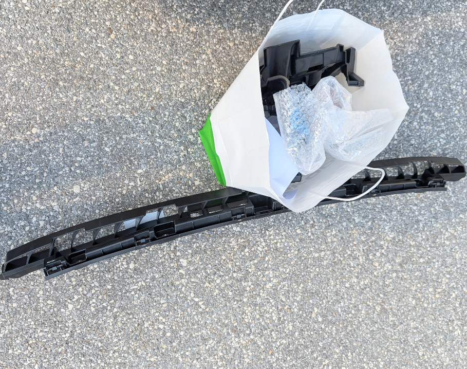

I picked up the last parts for the conversion today.

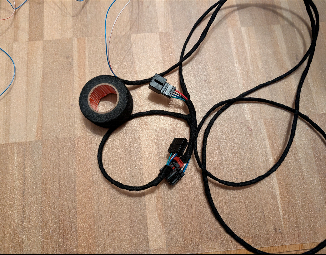

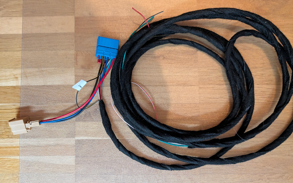

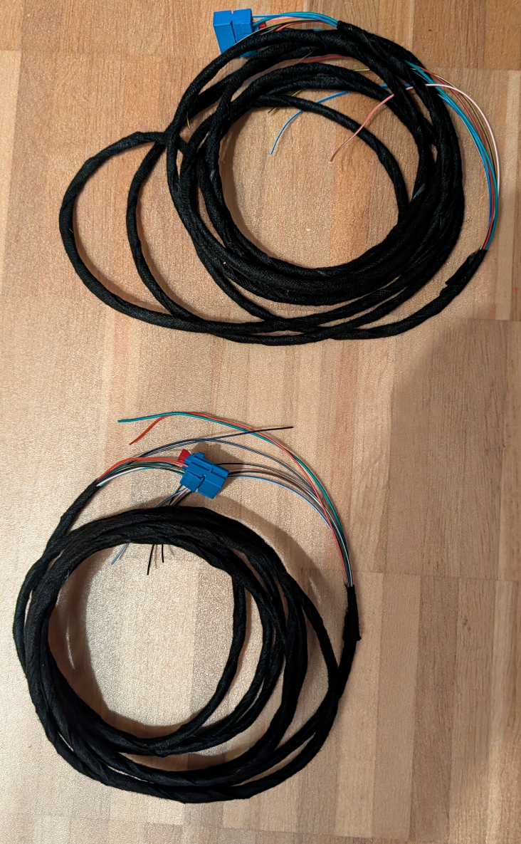

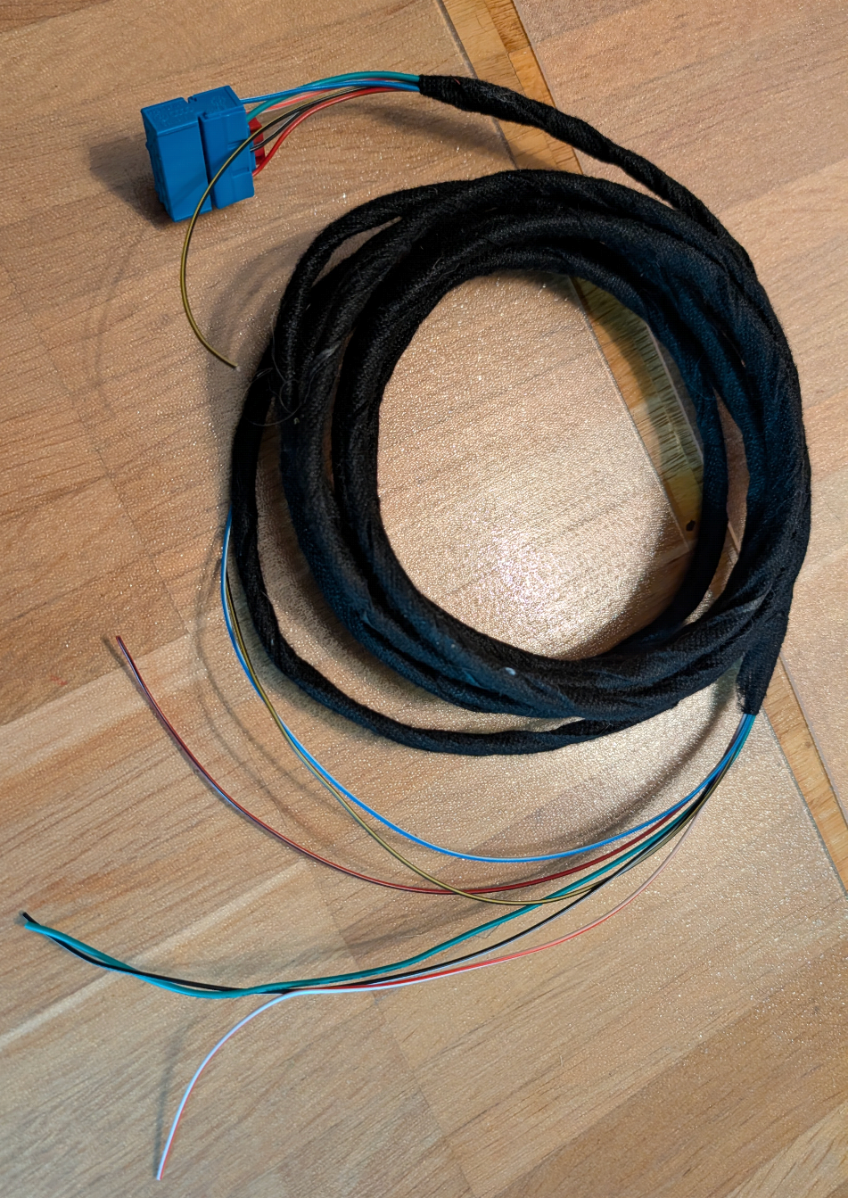

I've decided to go completely plug & play. I don't even want to re-pin the original wiring harness.
Edited by Cairus
So, the adapter on the left is now finished. Now I'm going to connect everything with a plug. I just want Plug & Play.So, the adapter on the left is now finished. Now I'm going to connect everything with a plug. I just want Plug & Play.

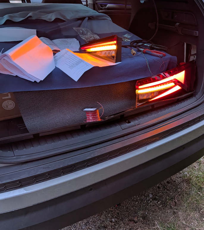

  • 4 weeks later...

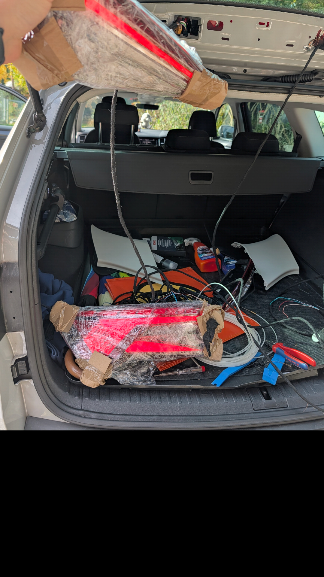

Today I briefly checked the adapters in the vehicle, it works as expected... maybe the first part of the installation will start this week

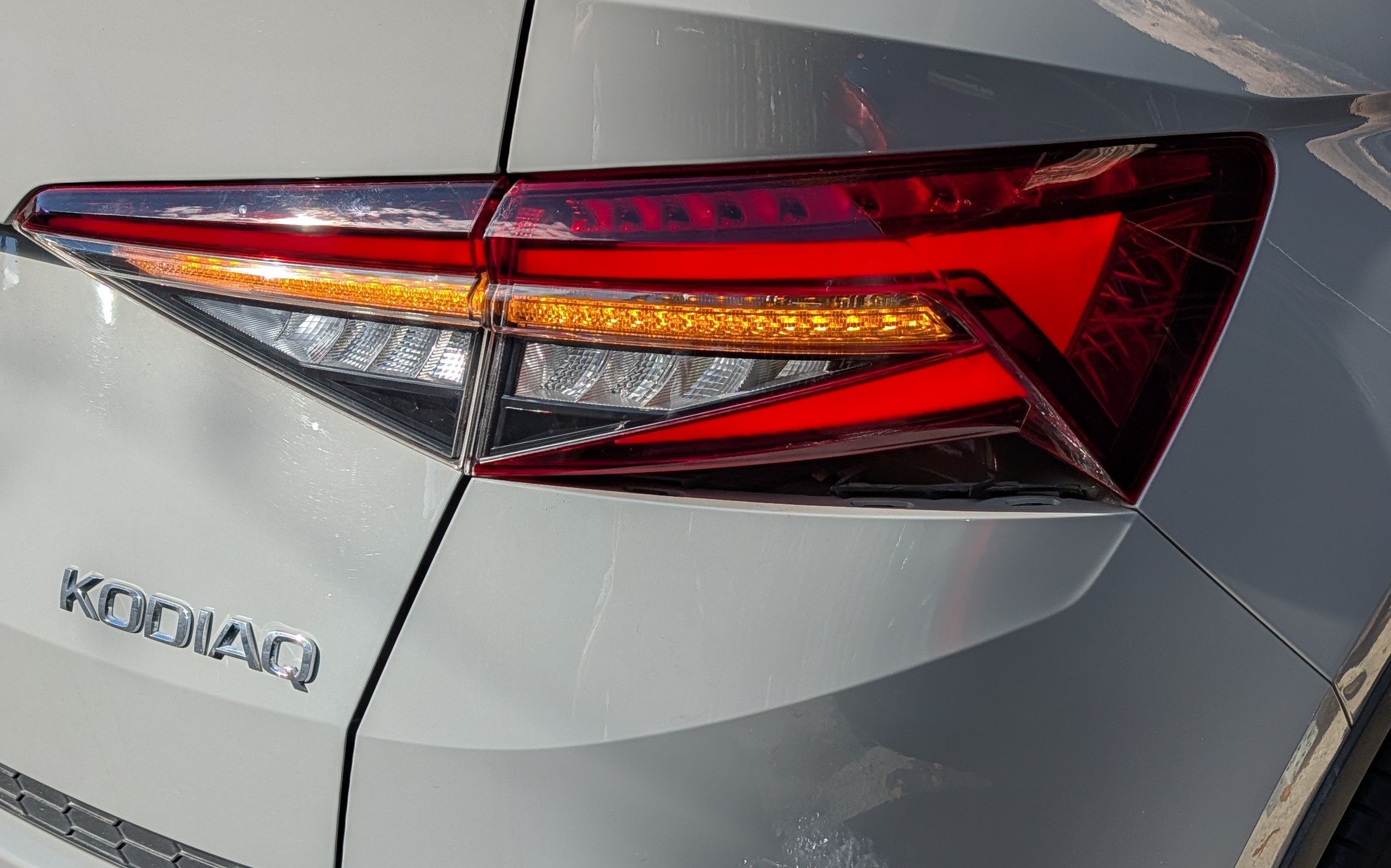

Update
Unfortunately, it looks like this at the moment; there's too much distance, with the new lights, regarding pedestrian protection, etc.
Now we wait calmly for the pole.
