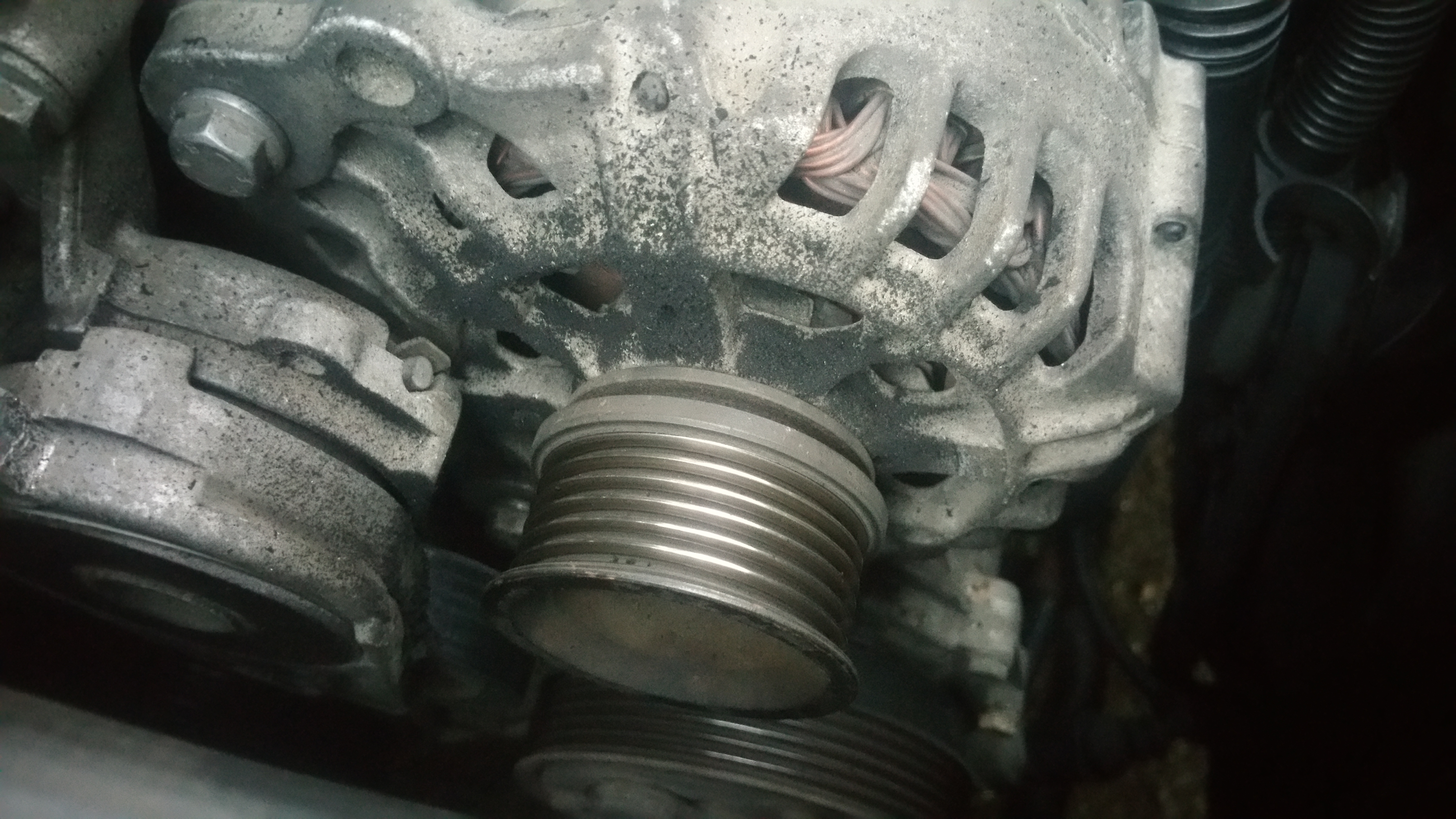

when i looked i saw this graphite looking dust on the altenator but when i went to take out the tensioner it felt like it was grinding when i took the tension off with a wrench.
So does it sound like tensioner stuffed or altenator or both??
hope u can see the dusty stuff in the attached pic.theres a fair bit of that dust on the underside of the tensioner also so could be just blowing up onto the A

If you grasp the alternator pulley with the belt off, does it rock like it is loose on the shaft? - engine not running obviously - don't want to be responsible for any missing limbs. :giggle:

nope the pulley there feels solid and free running (is it supposed to only spin one way?)
but the tensioner looks well shoddy. actually looks outta line. and i noticed that the pulley and aluminium case was wearing off the cam belt cover
Im guessing that a bearing inside the tensioner or whatever it turns on is knackered and has led to it sitting off kilter aswel,hope its only the tensioner anyway
To me that pulley looks like a regular pulley, not the one way driving type but I could be wrong.
Sounds like you have found your problem if the tensioner is knackered

That does not sound right on the tensioner, so that is one issue, if the alternator has a one way clutch, if you can hold the main alternator shaft from rotating - a flat blade screwdriver inserted into the centre of the shaft where the retaining nut is works for me, then the pulley will turn one way but not the other. If it does not turn either way, you have a standard fixed pulley. if it still rotates both ways, then the one way clutch is toast or the pulley is so loose it is about to leave into orbit.
