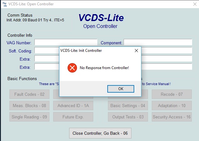

Hi,
I did try to connect my cable with octavia on win 10 and i have a problem.
What i am doing wrong?
Maybe can I use other program? I want just activate ''coming home''

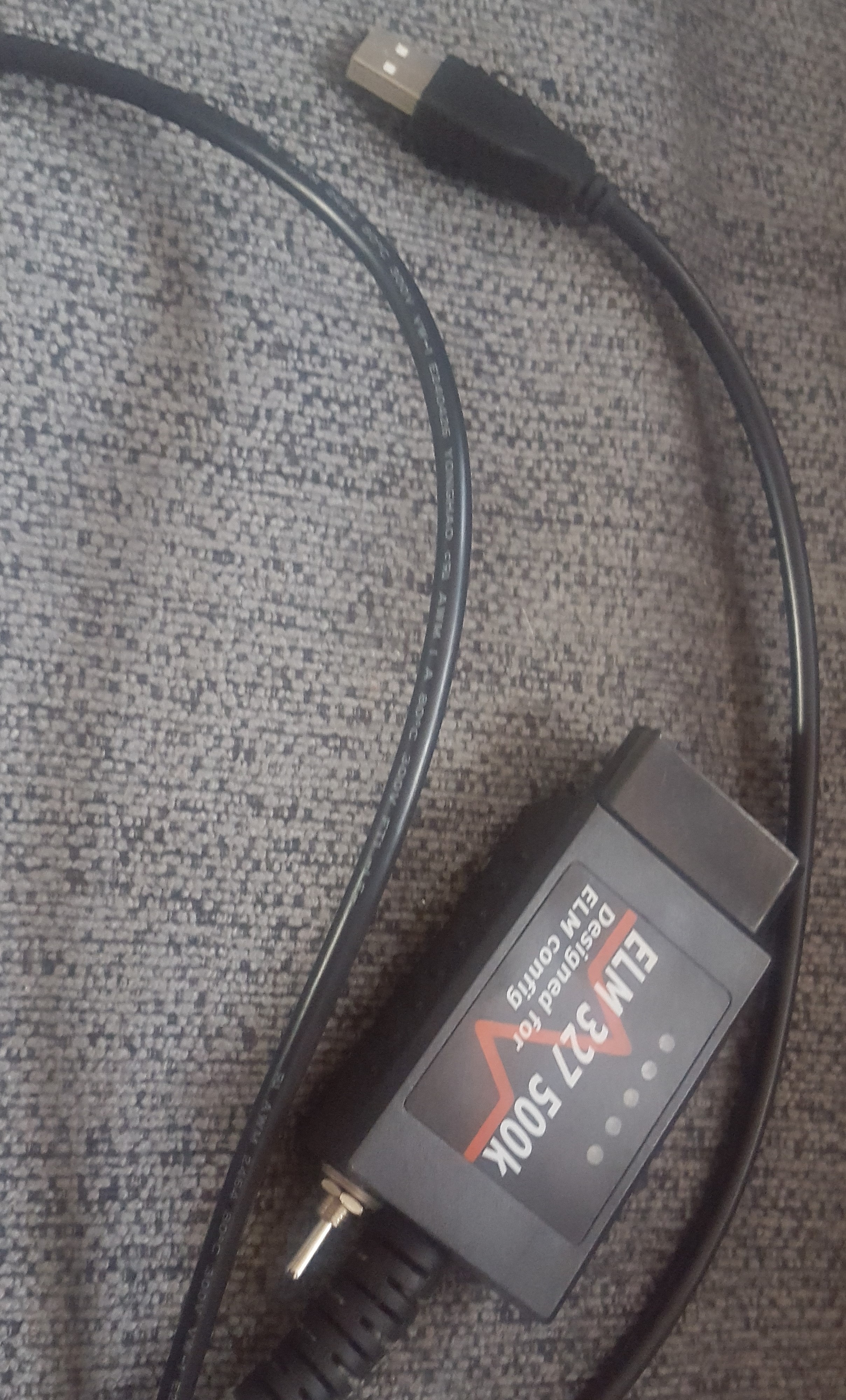

any software can i use with this cable?
Plenty but none that will allow you to activate the "coming home" that lead is just a basic OBDII cable for reading fault codes

You are using an the incorrect VCDS interface for your car (assuming you have the car in your profile picture). You need to use the full / newer VCDS (non-VCDS-Lite version) which requires it's own genuine Ross-tech interface as found here - www.ross-tech.com.
There are other alternatives, look at Carista for iPhone
