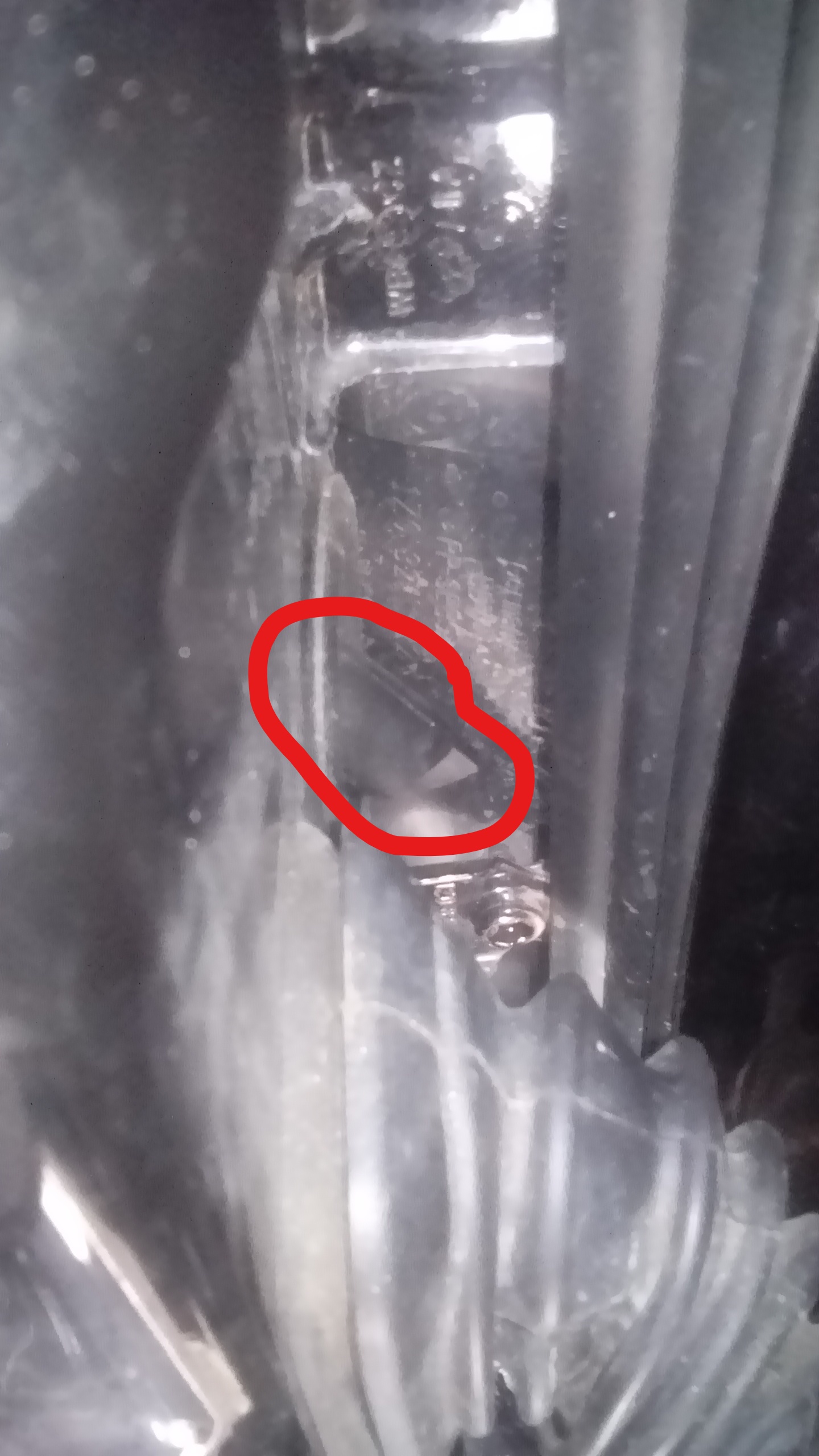

This is what/where I'm talking about, they view is from inside the open the drivers door looking through the hinges, you can see the end which is pinched by design:

Okay, so had ANOTHER soggy carpet last week, and it was our old friend the blocked drainiage tube (this time the passengers side for me). Anyway, further to pinching the end to free it up like I suggested, I would now suggest going one further...
The car doesn't need to be on a gradiant, but it helps, and open both the door & sunroof and pour a small amount of water, half a cup or so, into the relevant corner hole of the sunroof and watch how it drains. There's a fair chance it'll look okay, but mine was dribbling a bit out the end... until I started really rubbing the ENTIRE tube in the picture above between my fingers: after about 10 seconds, I got some real serious sludge coming out and then the water gushed out like a tap had been turned on! I think the entire rubber tube can bung up, not just the tip being gunky, so with the backload of water above it from pouring it in, it cleans out the tubes very nicely.
