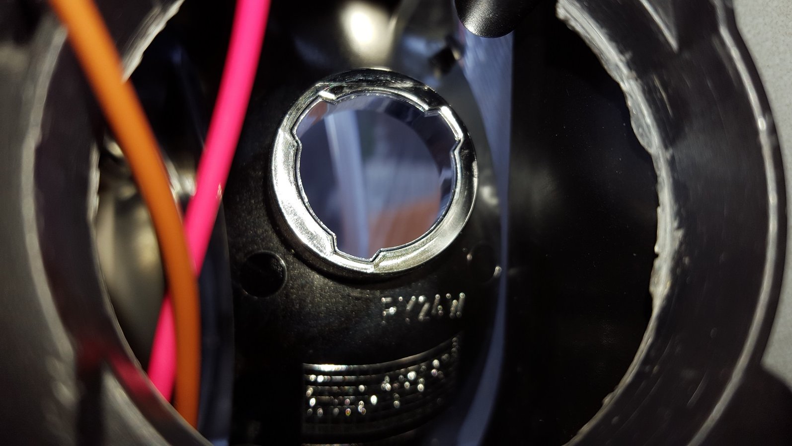

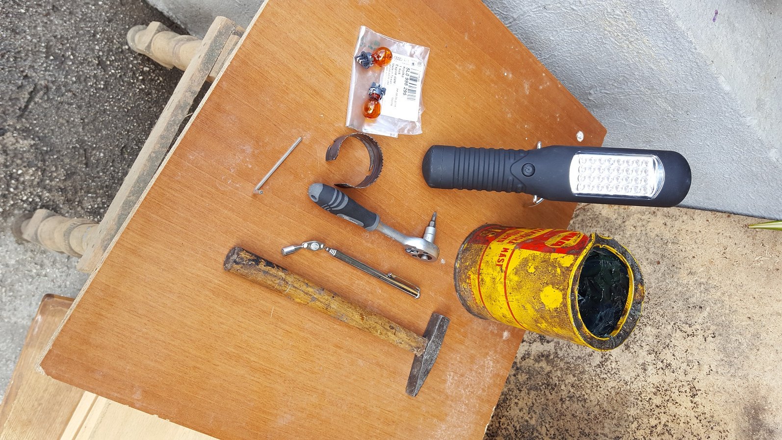

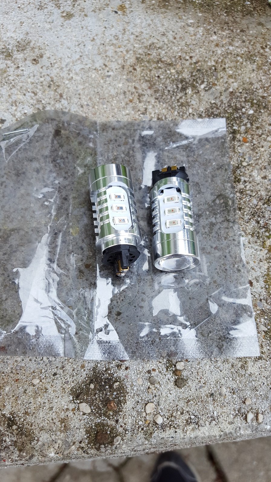

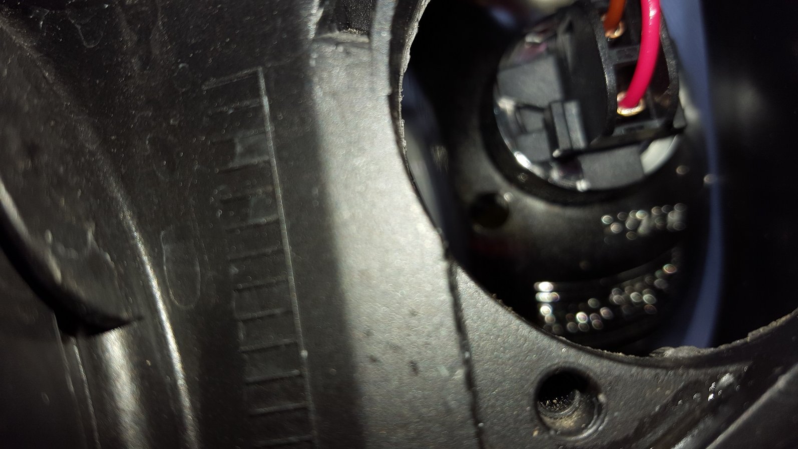

Front indicators are PWY24W. Can be done without bumper off. Harder, need strong fingers & some skill, but dooable. Pictures attached. On 4th picture there's pretty much all the tools I needed. Round saw was used to incision the opening, which was then fully broken out using wooden part of hammer.
Grease I used to grease the seal on repair kit, wasn able to push it in fully (access is very limited) before that.
