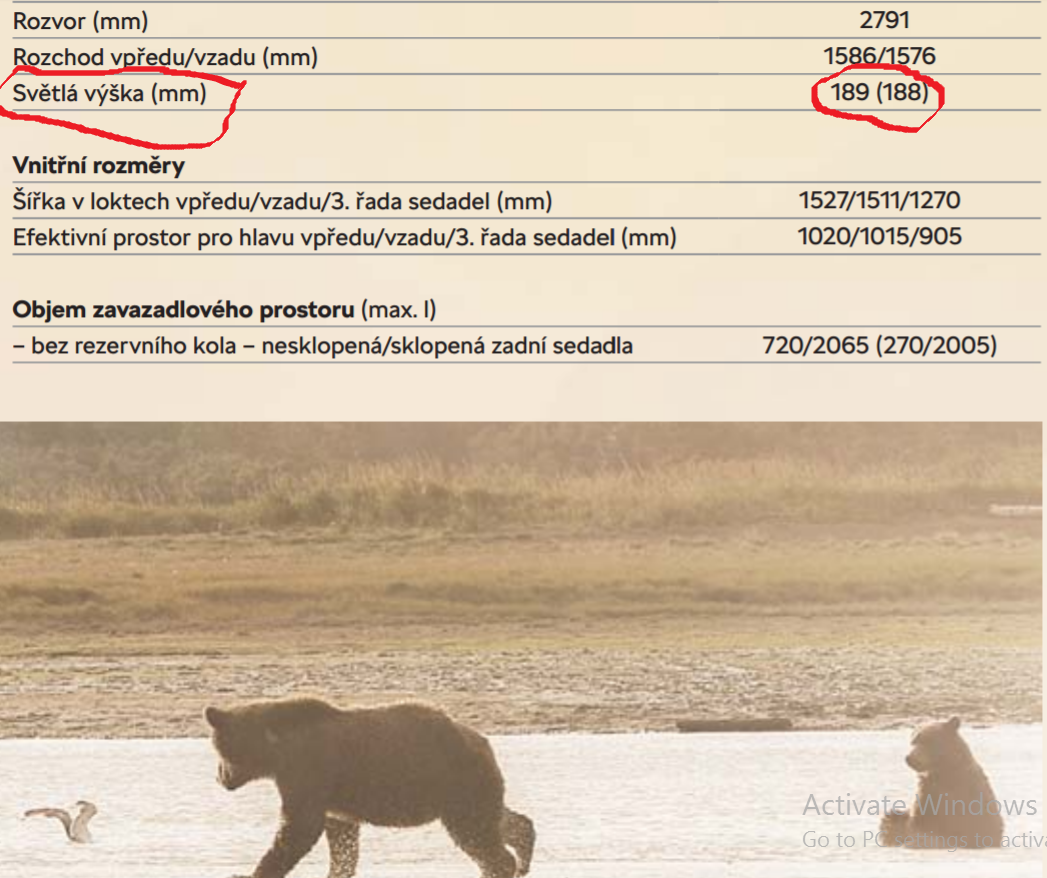

Nice point! Yes there is difference in superb, I checked the catalogue. I went firstly to Skoda.cz catalogue, bacause I always check them first, they should always give fresh info, bacause it is their native brand:) Looks like DCC doesnt affect Kodiaqs clearence. It is the same with DCC and without DCC. For 5 seats it is 189 mm and for 7 seats it is 188 mm. Here is the picture, svetla vyska is clearence.

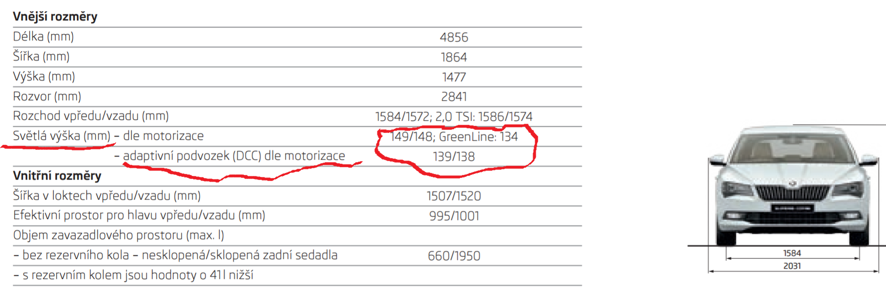

and these are data for superb hatch and estate. As you can see, there are differences if you choose DCC! I dont know what does " / " mean, but it depends on which engine you chose, this variation in 1 mm

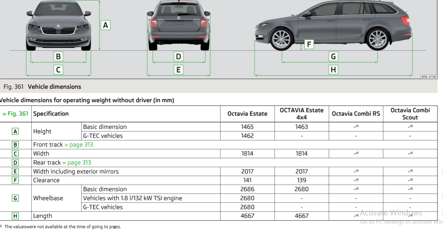

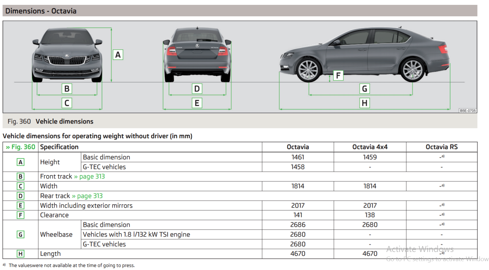

Looks like DCC does not affect Octavia FL hatch nor estate. I cannot find a catalogue with these data like in the case of superb and kodiaq, but here is the new user manual for octavia mk3 FL. Look ate the point F in the pictures below:

DCC doesn't change the ground clearance of the Kodiaq.
It is not about the change. The ground clearance is always the same. But in the case of Superb, Tiguan and Passat, the ground clearance is different if DCC is included.
