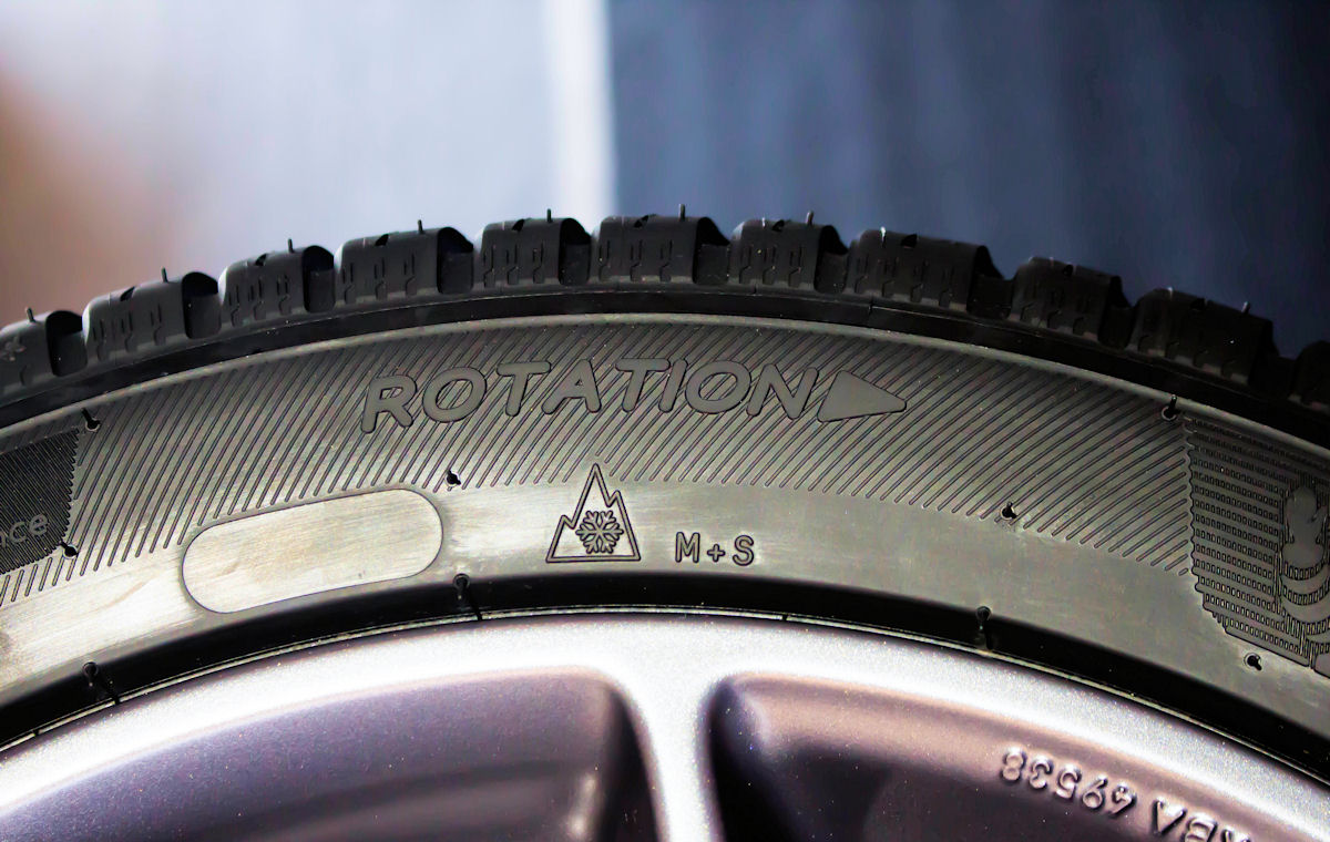

I can't remember whether they've got the M+S description but the pattern is less than ideal for muddy situations.
The Cross climates are Snow Flake Three Peak & M&S marked.

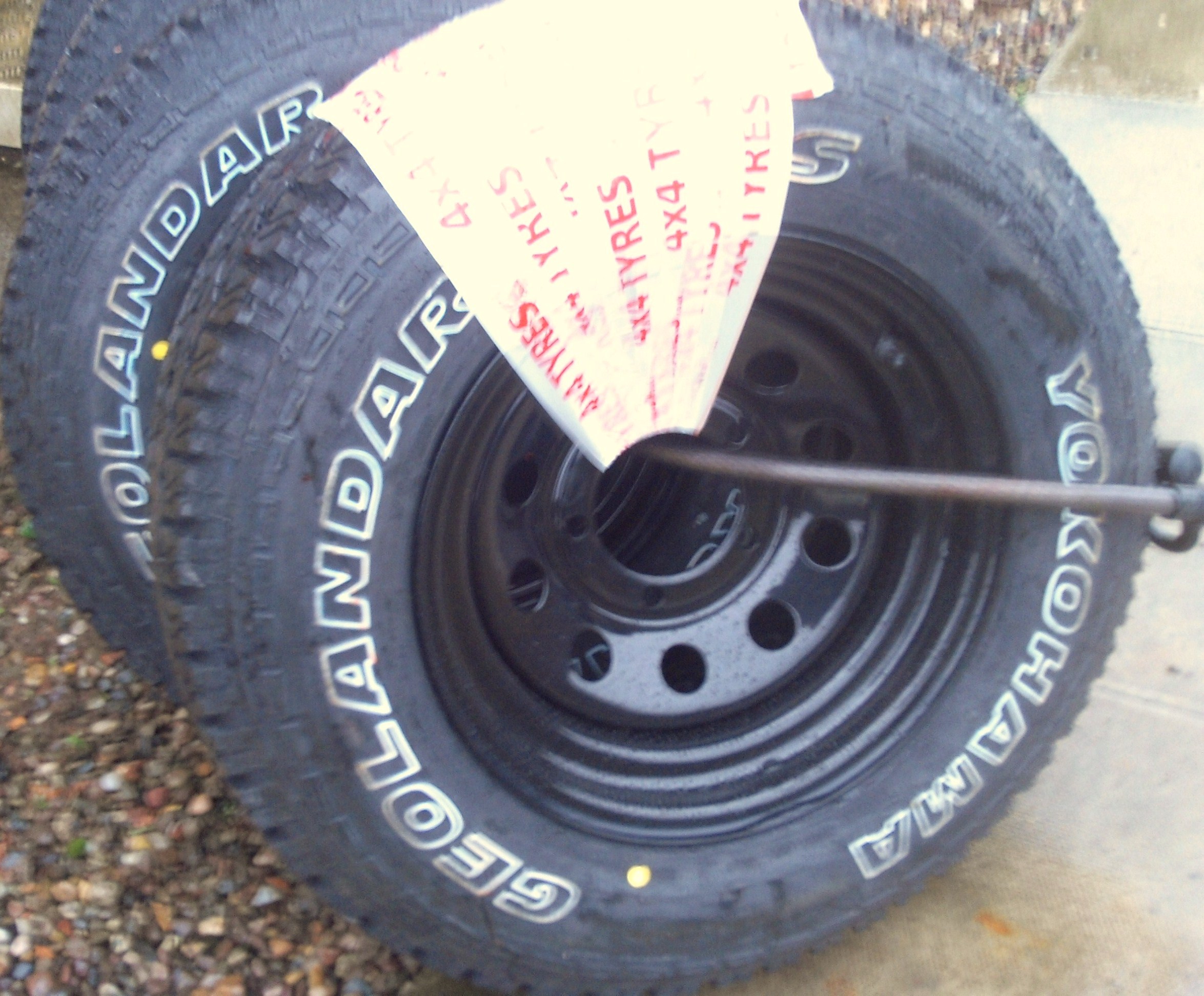

If Mud and tracks are important then best buy All Terrains suitable for a Yeti as there are ones available and they do not have to have white lettering on the outside tyre wall. You can get ones that do well in winter / snow even if not Snow tyres and they will do a better job on Mud & Grass than CrossClimates.
Maybe even BF Goodrich (Michelin) All-Terrains would suit.

Those Yokohama All Terrain Tyres in the picture are what is fitted as standard to the Road going Arial Nomad so they do OK on road,
but best check what All Terrains come in the size you need for the wheels you have.
Ok, now I want an Arial Nomad! Not sure SWMBO would approve though ...

It's also heartening, from the picture posted by Jon TDI (thanks!), that the Cross Climates have an M+S label - I've always found their food very good too :D  Seriously, however, does the M+S sticker truly suggest some degree of improved muddy performance over a standard tyre? Or is it mainly cold weather performance that they're aiming at in this case?
