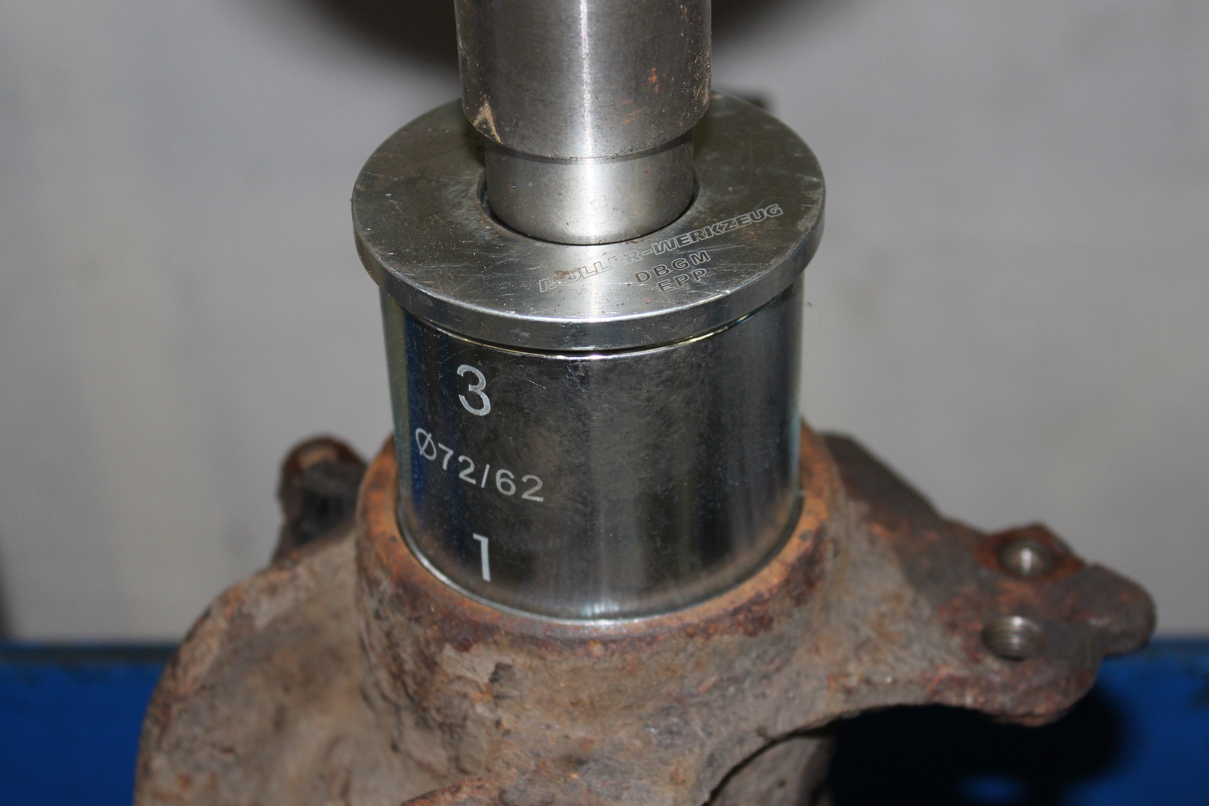

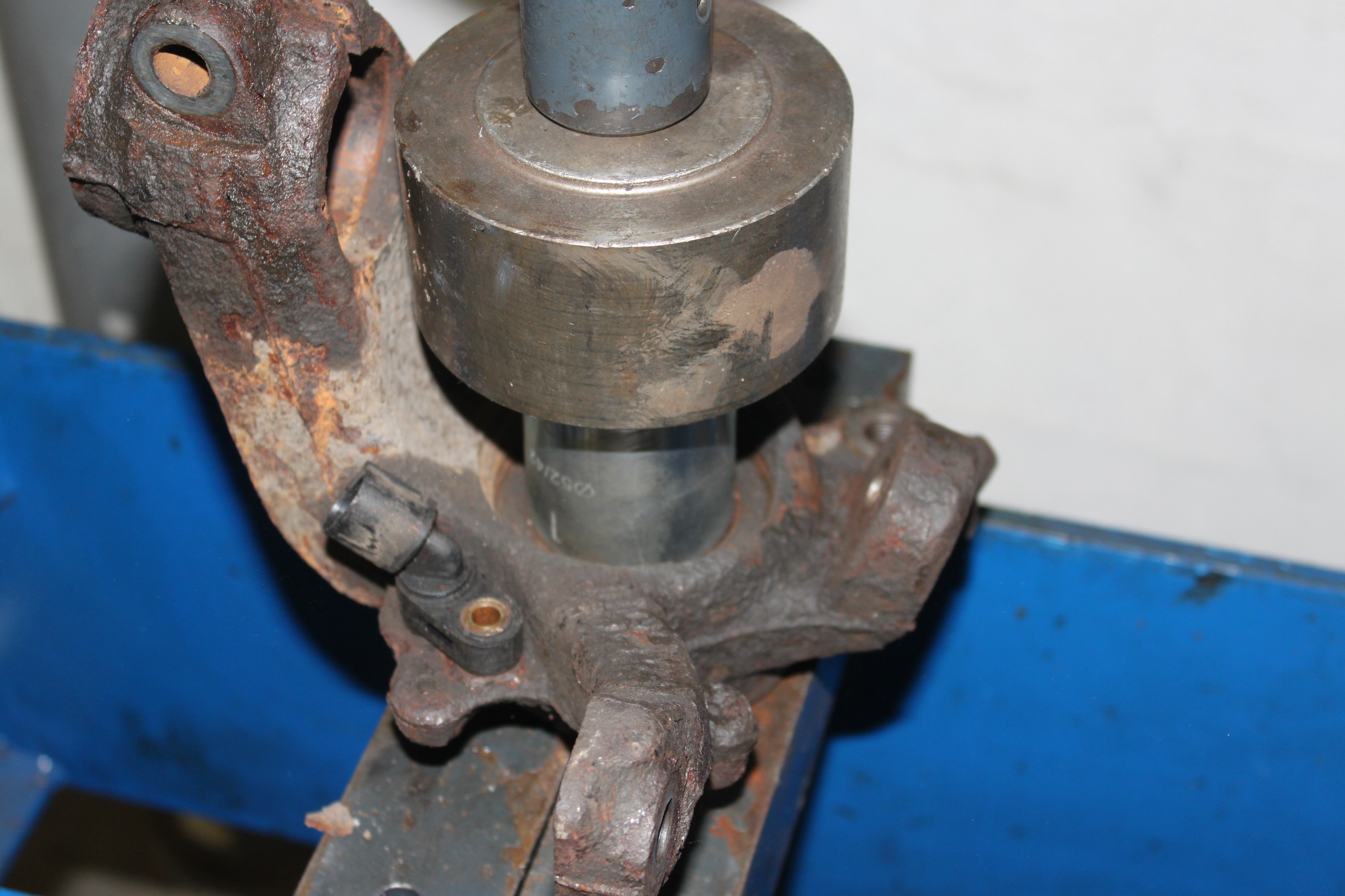

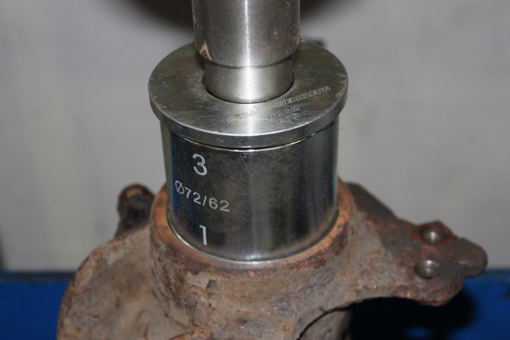

LHF wheel bearing as we suspected then. Take note that there is a specialist tool for fitting new bearings, and a normal bearing press will distort them.

For VAG bearings certainly; I'm not really up to speed on other makes these days. If you can hear the noise, jack that front wheel up off the ground, support on an axle stand, and holding the wheel top and bottom rock it. Now have someone apply the footbrake and repeat. If the play reduces, the bearing is worn.
Something like these....
