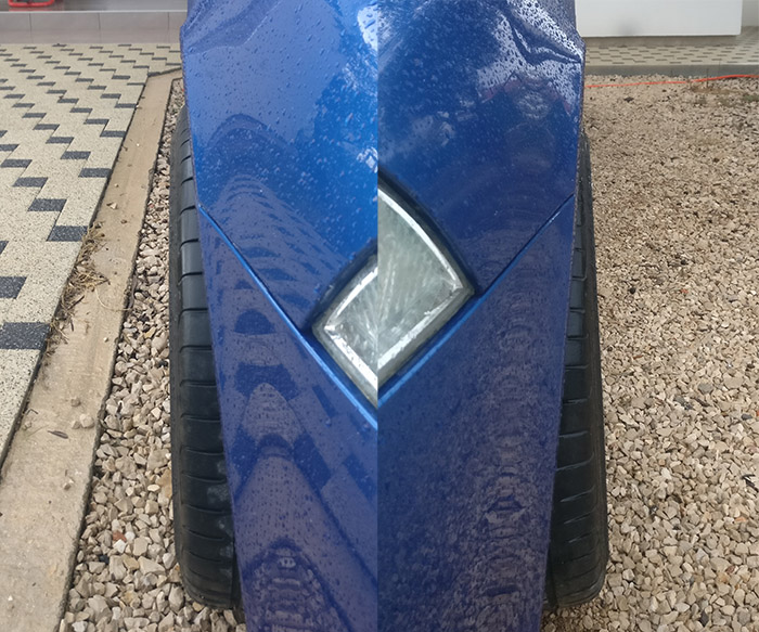

As per my thread over in the Octavia II forum, I've got myself some new wheels for the vRS, they're 8Jx19, no offset stamped on the wheels but they're Audi A4 fitment so I assume ET35
Car is on stock suspension, I test fitted them before buying and although they're wide there was no issues with them catching at full lock with seriously uneven ground and they've done the 90 min drive home without any issues
Now there's a couple of issues, firstly, have I done a silly and let the nice shiny big wheels tempt me into buying them when in reality they could cause issues?
Secondly, the car appears to have more offset on the RHS than the left, as far as I know there's no hidden surprises in the history of the car, but is this a big problem?

Hmm, now I've compared the two photos it looks like it's not the tracking but the toe that's causing the apparent difference!!

The car had its annual service today and the mechanic who I know and trust gave an emphatic no when I asked if he thought I'd have any issues with rubbing when lowered...
Will get the alignment guys to have a look at the apparent difference in the track left to right but right now I'm happy with the result... :)

I fitted a set of Eibach Pro-Kit Springs this week and had the alignment done, still a little offset to the one side but the guys said it was to Skoda specs, respected place with proper Hunter machine
