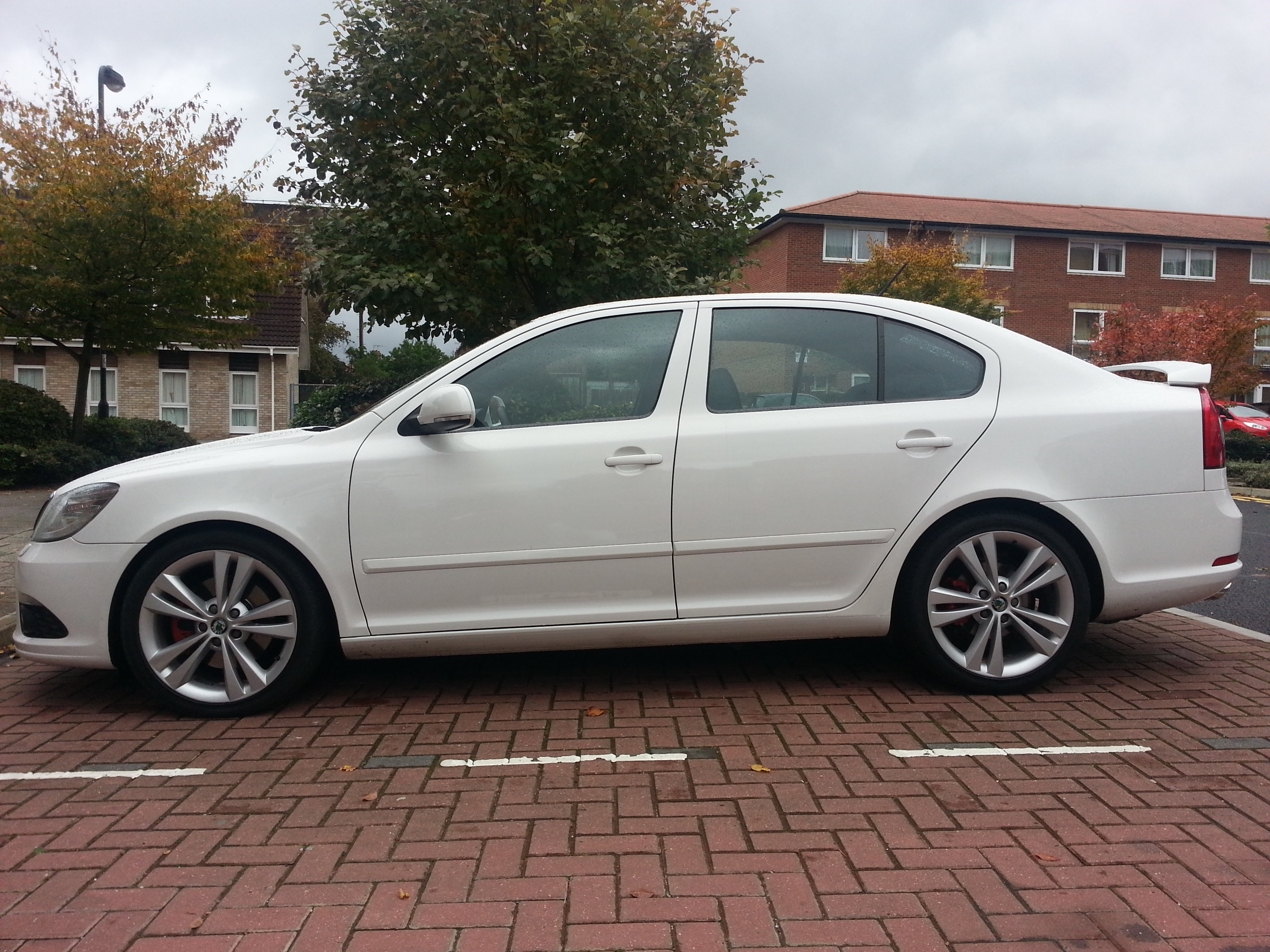

I just finished fitting the Eibachs to mine today, very happy with the results, will post a picture in another thread...
Thank you. Want to see the pictures
Pictures here
I'll probably do a walkthrough install when I get cleaned up a bit...
Edited by hrvrs
Looks low enough for me. My ex VRS was sitting on PI springs fitted by first owner. Regret that I sold  her very much
