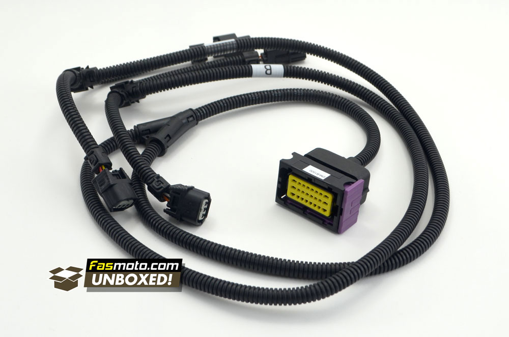

If you mean are they a permanent fitment, then the answer is no(ish). If you mean are they hard to fit, then the answer is also no(ish).
The Throttle Response is probably at most a five minute job to fit first time and then it's a thirty second job to remove or reinstall. The Throttle Response had the electronics housed in the controller but the XLR now has a separate controller and electronics box so may not be as easy to totally remove and reinstall. Take a look at @philpix's post.
The RaceChip Ultimate tuning box was a 30 minute job to fit on my 280 TSI. The non-app version I have has two sensor connections to the engine, one located at the top of the engine and one at the bottom.  I believe the BlueTooth app version has a third connection (for BT power?).
On the 280 engine you ideally need to jack or ramp the front to temporarily remove the plastic sump guard to gain easy access to the bottom connection. I don't know where the relevant sensors are located on the diesel versions.
They say a picture paints a thousand words...
racechip-pro2-honda-civic-fc-1500cc-turbo-unboxed-8.jpg.0d9f81e40929a52ae03b6cdedb3ab314.jpg
That large square connector plugs into the RaceChip tuning box which itself is not much larger than a pack of cigarettes. It can be located anywhere that is convenient but ideally away from sources of excess heat. I used long cable ties to secure the box and shorter ties to secure the cables.
The two sensor ends each have a plug and socket. You remove the two engine sensor plugs and plug them into the respective RaceChip cable's sockets and plug the RaceChip cable's plugs into the engine's sensor sockets. When fitted, the sensor data from the engine is sent up the cable to the RaceChip box where it does its trickery and sends the modified data back down the cable to the engine management.
The provided dongle that you plug into the large square socket, after unplugging it from the RaceChip box, is merely a bypass so the engine sensor data is sent up the cable and back down to the engine management without alteration, effectively returning the engine to original performance.
It would be a pain if you felt you needed to disconnect and remove the cable and box on a regular basis. I just use the dongle whenever the car needs to go to the workshop.
I hope that answers your query. :)
