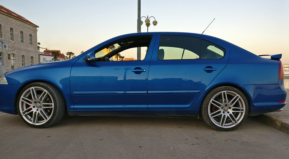

Yes, yes they do... :D
Wheels are Audi RS4 replicas 8Jx19" wearing 225/35R19 Goodyear Eagle F1 Asymmetrics
Springs are Eibach Pro-Kit, part No. E10-79-004-02-22
No issues with rubbing or anything (yet)
Handling is much improved, body roll reduced, smoother on small bumps but harsher on larger compared to stock vRS springs

Stock shocks, they had ~125,000km on them and I figured I'd see if they lasted with the new springs, no issues so far and we're on 142k now, when they go it'll get Eibachs or similar
The ride quality is reasonable, considering the reduced suspension travel and tyre compression available, it's noticeably different but no more than you'd expect it to be
It's been a year now and the downsides would be increased likelihood of grounding the engine sump, and four up with adults plus luggage if you hit a whooping motorway joint expect the rear tyres to rub a little, nothing serious but worth considering if you frequently have the car loaded up
Still happy with mine, I accept the downsides because I like the style :)
