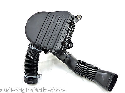

Is this what you have on a 1.2TSI ?
People want to to better intakes on a Twincharger so they change them.

Yes it looks like that picture but I am not sure if the bore of the trumpet going into the airbox is larger diameter.

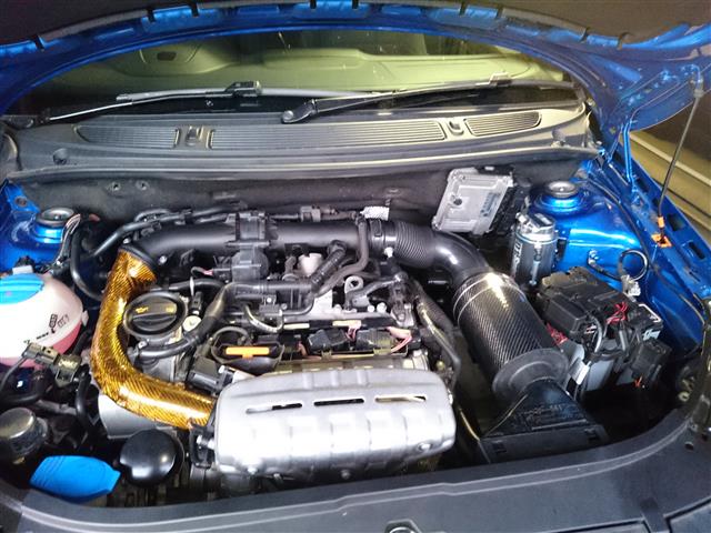

Just a quick question does the twin charger have two inlet pipes into the airbox to feed the supercharger and turbocharger?
No one big pipe going out the air box as in the picture.
Pics from Google Images.

Interesting photos thx are they your car- if so, I wondered what you did with the original airbox and intake pipe/ trumpet ?
No not mine, just on Google Images but from Briskoda threads.
Just put a wanted ad on Briskoda, plenty remove the air box, but some do keep them to replace when the car is being sold.
Or just fit a suitable Induction Kit that fits, they get advertised occasionally in Briskoda 'For Sales'.
