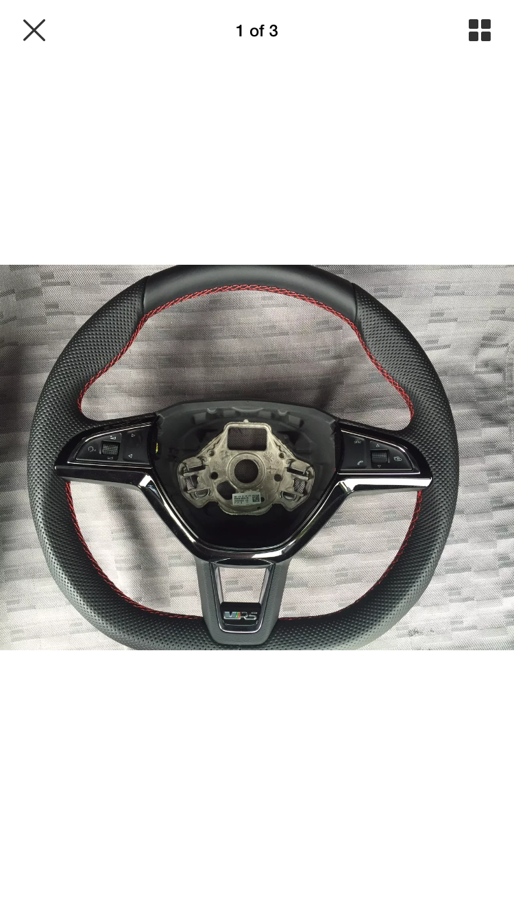

can anyone confirm what other wheels will work with this slip ring,mk3 wheel ?
ideally was looking to fit this wheel
but can source one at sensible money,what other wheels would work ?

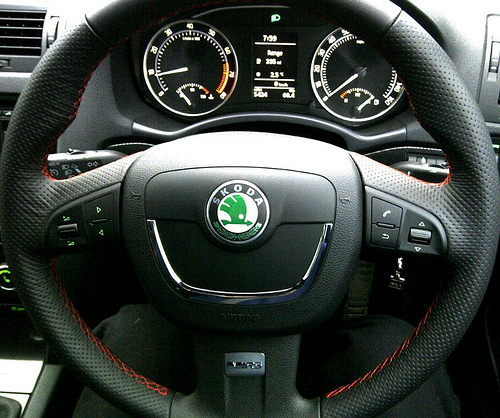

I can tell you 100% it works as I have fitted one to my mk2 but fitting differs depending on what your car has already.
Eddie nl is your man for that info.
Fitted and working in my car
Yes that's what I mean,so a mk3 wheel won't work ?
Isn't this the same wheel and switches though?
The wheel will work as it just bolts on.
The switches won't but you remove them and replace them with superb ones.
Those switches look the same as yours though ?
its all very confusing to me lol
Edited by gizmo98
Please read and take on board what I am telling you.
I have done this and am telling you the switches do not work.
Octavia 3 and superb switches are a different part no.
The octavia 3 ones do not work in a mk2 octavia but superb ones do.
The wheel will bolt on no issues.
The switches need to be removed and replaced with superb ones to get them working.
Then if you have no mfsw from the factory you will need vcds coding to get it working.
As Tubbytommy said, you'll need buttons from a PQ based car such as the mk2 FL superb.
The buttons from a MQB based car such as the mk3 superb or mk3 Octavia will not work.
The wheel and airbag can come from either.
